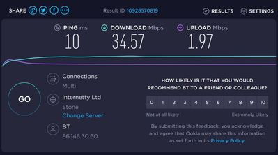

your current stats are same as those posted on 12/2 confirmed by dsl connection time so don't think you had a line reset yesterday/last night
can you run btspeedtester with ethernet cable and post results please  if that is a problem try speedtest.net

Thanks @imjolly . Results from speetdest.net are attached
