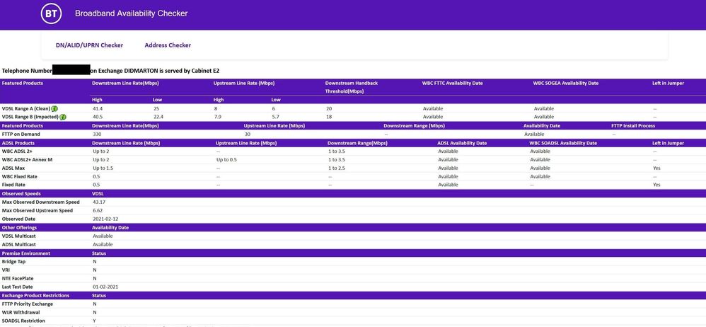

Hi @imjolly , we are on Didmarton cabinet E2. I will post the full report for you just a moment
DLM reset was performed on 9th Feb by and Openreach engineer after resolving minor wiring issues in the cabinet.

so you are on a Huawei cab so if you can get your connection sorted out and stable then you should get a boost when DLM activates G.INP.  just need to get connection sorted

After the DLM reset on Feb 9th, the download sync speed snapped up to 40Mbps after the first full 24-hour day of connection, and has stuck there ever since. I have to admit I thought that was G.INP activating at that point, and thereafter I had high SNRs just because there was a 40Mbps cap on the cabinet. The connection has been rock solid since, so I'm not sure how much more sorted it can get.
The original topic remains - is there enough evidence here to sponsor a re-provisioning of the line to allow us to break that limit? As it stands I believe we can never see the max speeds shown on the checker, even though the line seems to be capable.

the maximum speed from checker estimated range  is 41mb  - just 1mb higher than current connection
that is not a fixed limit just the expected range - sometime customers do get better than top estimated speed
you/we  are just going round and round so have asked mods to check if you are on the old essential max of 40mb or in banded profile or just line problems
