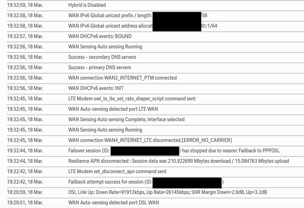

@NeilO  A quick update:
G.Fast over copper works most of the time here in South Central London but get too many drop outs/failover to Hybrid.
Notes:
1. Weirdly after many Open Reach engineer visits then nothing between around July '22 when it would be solid for days/weeks it would avg 125Mbps down, it suddenly started dropping main connection but reconnecting at avg 130-140Mbps (Hybrid disabled) - but now either daily or max few days reconnects. Open Reach engineer swears nothing has changed... got sent new SH2... no change
2. As work from home, re-enabled Hybrid, which works when BB disconnects but takes avg 3-4 mins to fail over and then seems reluctant to fail back once it has the connection - can see main BB back up but can be 10 mins before it finally fails back e.g.
19:20:59, 18 Mar.
DSL Link Up: Down Rate=91912kbpps, Up Rate=26145kbps; SNR Margin Down=2.9dB, Up=3.2dB
19:32:44, 18 Mar.
Resilience APN disconnected : Session data was 210.922699 Mbytes download / 15.084763 Mbytes upload
Why the 10 min+ fail back?
No easy way in mgmt page to force it to switch back. BT App may do.
3. Weirdly also appears to work better / less chance of false fail over if Hybrid is connected via wifi not ethernet. As someone who has worked in cyber security but basic networking in 1st job, that makes no sense. Far faster to switch between cabled networks than wifi...
