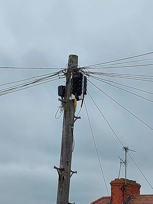

Good morning everyone,

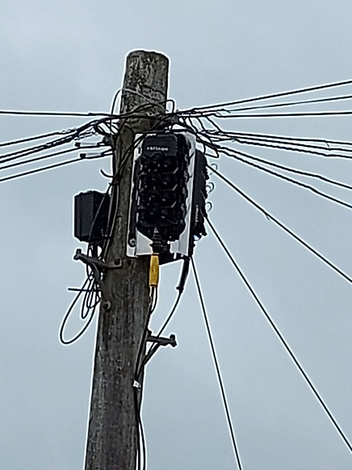

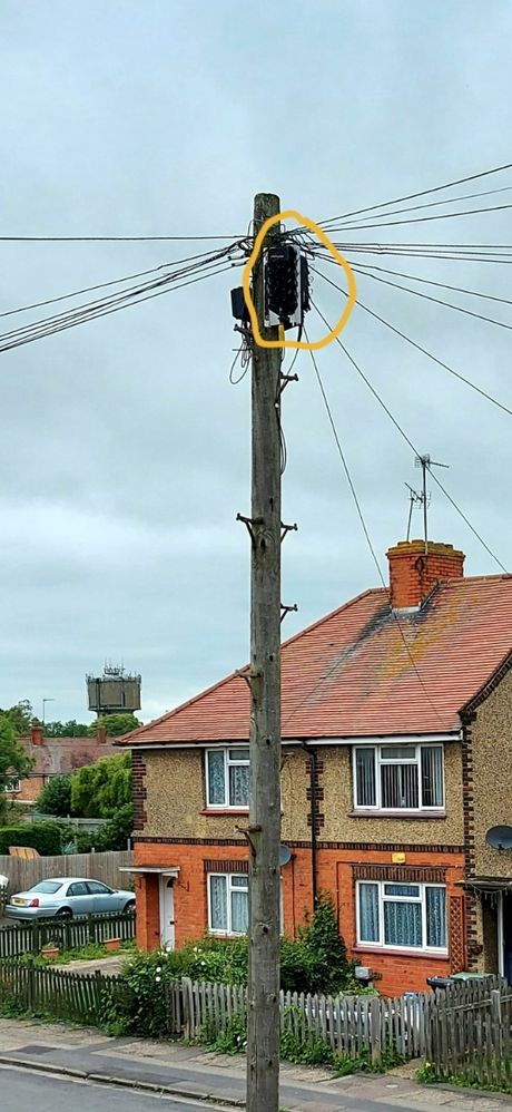

2 days ago the pole outside my house had spray paint markings on the floor that looked like 5/G. Yesterday, 3 guys, a van and a cherry picker from Opals were moving down each pole to which I thought they were just doing some sort of maintenance on the poles. At the start of the day one of the guys nailed on a small yellow sign that said "caution, overhead fibre". Later in the day they fitted the following onto the pole.
20210630_094112.jpgIs this the beginnings of FTTP? The best we can currently get is FTTC. The thing that confused me was nothing was done at ground level in terms of power to the new "thing" on the pole. Also no work was done in the manhole by the pole. Does someone else come out and move the cables from the original box on the pole into the new one? If it is FTTP, how long does it take from this point until being able to order it?
Thanks for any help anyone can provide.

Heyya.
That is a Connectorised Block Terminal (CBT) used by Openreach to connect properties up to their FTTP full fibre network. It does look like you're in a good position but what does https://www.openreach.com/fibre-broadband/ultrafast-full-fibre-broadband say?
Once Openreach have done all their works it will go through some testing before going live and Openreach will be letting Communication providers such as BT Consumer know that FTTP is available. Keep an eye on  https://www.broadbandchecker.btwholesale.com for your property and once it's shows up as below for WBC FTTP (not FTTP on demand) you can call the BT Consumer full fibre team to place an order - 0800 587 4787

AFAIK , the CBT comes with a pre-installed fibre tail ( cable ) of a set length , the planner will have indicated the length of tail required , for it to be run down the pole, into the underground duct network to the allocated splitter node , that will be in a joint box nearby ( the tail may be 30,65,100 metres, or whatever ) so attaching the CBT to the pole and leaving the cable coiled ready is the easy bit…that not to say it will be a long time before the next stage is completed, obviously if the cable has already been taken down the pole and through the ducts to the splitter , provided the ‘spine’ network to the splitter is complete, then it shouldn’t be long before the CBT is ready for service
