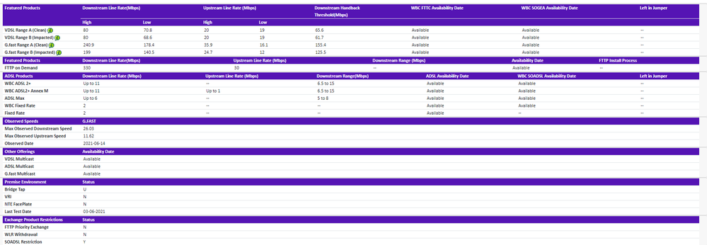

Here's the results

Re: Limited download speed - DLM?
From your initial post I assume you are on G.FAST.  you speeds are no where near expected and explains the very high noise margin.  Do you have a dial tone on your landline?

Yes I am on G.fast
I've just checked the phone and I have a dial tone
3,909 Views
Message 8 of 8
If you have a dial tone and there is no line noise then report a fault
