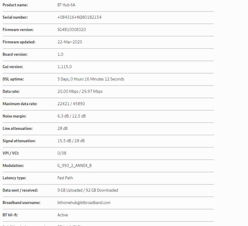

in order for the forum members to help please can you post the stats from your router (if hub enter 192.168.1.254 in your browser) and if  HH5 then go to troubleshooting then helpdesk and if HH6/SH2 then advanced settings then technical log information .

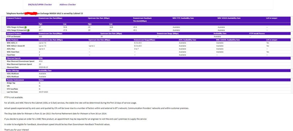

enter your phone number and post results  remember to delete number   https://www.broadbandchecker.btwholesale.com/#/ADSL

Stats below:

You line has not been capped, what has happened is DLM has taken action in an attempt to stabalise your line due to the fault. Now that the fault has cleard DLM shoild automatically raise your speed. Your connection time is only 5 days so there's still time for DLM to relent.
As log as your connection stays table for the next few days all shpuld be OK. We don't know if you have any noise on your line though as you don't have a handset. This is the simplest of diagnostic tools available and for the sake of less than £10 for a cheap handset well worth the price.

According to dslchecker results you had a 45mb connection speed on 15 June so were you using experiencing drops in connection which is why you had engineer visit.
as @pippincp  posted your drop in speed was due to DLM and not need to wait until it sees line stable and starts to increase speed. You need to avoid and resets

I will wait then and report back, was completely unaware of DLM's existence. For my education, which part of my screenshots made you realise the above? Was it the "VDSL Range B (Impacted)" ?

You Noise Margin is what suggests DLM has taken action. Would be happier if you could check to make sure no noise on the line though.
