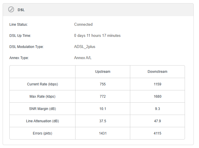

After a total of 4 engineers visit (Having had 2 engineers visit last week) and I still get this:
See that it is only 4 minutes, I only saw that after I logged in the router so that means the connection has been dropped itself.
BT advisors on the phone told me that they (also the engineers) did the test on the line and found nothing wrong with my line, they think it is inside my property!
How that can be?  My router is connected directly to the master socket next to it and still doing poorly.
All I know is it just happened after the storm back in early July! It has been fine for years prior to that and nothing inside the property has been changed! Can I make this any more clearer?

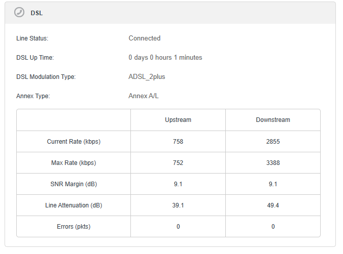

I just did the BT Troubleshooter online minutes ago to test my line and told me to wait a few minutes for 'my hub' to restart and after that, I logged into the router to find the speed is near normal although the uploads speed is quite far off from what it should normally be (around 1000 kbps) so the line is probably not 100% what it should be. I suspect that if BT engineers can't find what is wrong with the line then I will consider it a 'dead' line and I would want to request a termination of my contract based on it because it is unusable.  It would be a nightmare, had I owned one line that happens to be problematic. Just not worth the hassle of trying to get it fixed if the previous 4 engineers could not get it fixed?
Here is the latest stats just after doing the BT Troubleshooter using the test socket (however it was the same with front plate after the troubleshooter before removing it prior to checking the stats).

if that is same line which had the 348kbps then connecting to test socket has made big improvement as now at 2.85mb and potential to go up to 3.3mb.  with stable connection your speed should start to move nearer attainable
the reason to check for dial tone is the phone needs both wires connected to work whereas broadband can work with only 1 wire connected but it usually is very slow

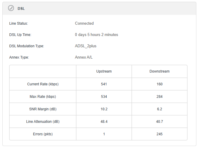

Checked this morning @ 912am, here's the stats, you can see the speed has dropped:
Then again this evening @ 749pm, it seemed to have disconnected itself a few hours ago and dropped to very low:
Notice the SNR Margin especially the downstream, it is more or less the same despite the huge speed drop.
So what I was saying that every time the engineer comes and think he/she has fixed it then the same problem came back a day or two later.
