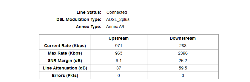

Last week, I noticed that line 2 had a few public ip changes over the 5 days so I thought there was disconnections so I replaced the router with a spare one in case the first one may be faulty.  However it is still doing the same so here is the stats, has not improved at all.

has your connection remained stable when connected to test socket?  unfortunately the stats don't show internet connection time not system uptime which is different

Unfortunately, we had a power cut yesterday. Despite this, the first line is still great.
And yes it still connected to the test socket and it seemed to be stable although slow at 288 kbps but only that I have noticed that the public ip changed itself a few times meanwhile line 1 is still with the same public ip.

if the IP changed then there has been a drop in internet connection which unfortunately starts your stability time all over again.  if only 1 change in IP was for power cuts then other drops are line problems

That is what I thought so, which is why I swapped the router to ensure it isn't the router fault but if it does change ip again and again then the line needs to be looked at?

Yes the IP will normally change everytime you drop internet connection. If line keeps dropping then you will not get out banded profile

It is still struck to 288 kbps profile which it has been for more than a month now.
So there is definitely a problem with the line 2 so I would like to request an engineer visit.

are you still finding you are dropping internet connection ( hub IP changing) and that is causing the speed to stay at 288?  If so then phone CS 03301234150 and report line fault not broadband
