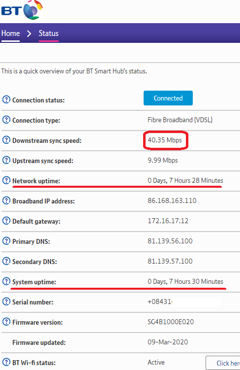

It looks as though DLM probably reset your line 3hrs 57min prior to your screenshot (the system uptime is meaningless, it is just the time the hub has been powered). The line reset would have caused the change of IP address as you would have picked up a different address from the pool, all as expected.
3,953 Views
Message 12 of 31
Re: Lower speeds and different IP
Hi
The system uptime I have noticed is not really the time hub has been powered in my observation. It may of course be linked to the kind of resets done remotely, but my router has never been powered off for months. Usually the 14 day resets by BT resets the system uptime as well, and any restarts in between ( like the one happened this morning) usually do not reset the system uptime, and update only Network uptime. At least that is my observation on my router. And the resets do not always pickup a different address as I have noticed, although that is possible of course.

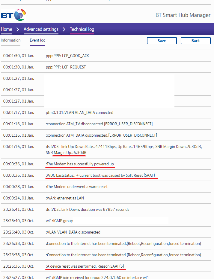

Here is the reboot logs that happened today. The reboot was performed by BT remotely I think using ACS. The system time and Network time was reset. But everytime these remote reboot occurs, the speed seems to drops a little bit. From what I understood from the experts in this forum in various posts that the remote reboots should not generally affect the sync speed. But speed drops do happen in my instance when it is connected to the same network (if I can call it?). As I said, not so much as to complain, but it does seem to happen. Could be there is a genuinely different reason for it.  Maybe if it is left alone, it may pick up, but that probably would be weeks away.
Just posting it here if someone can make sense of it all and maybe useful to someone else. Not complaining though
Take care everyone 🙂

The reboot in itself won't cause the drop in speed but if the line has deteriorated, the hub will resync at a lower speed to maintain stability.

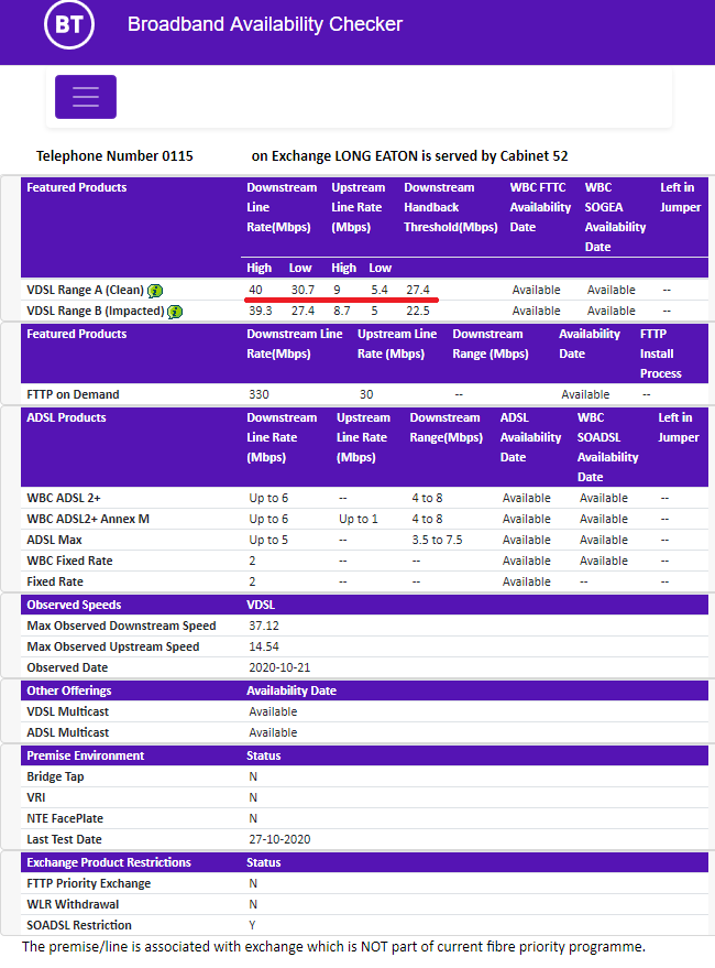

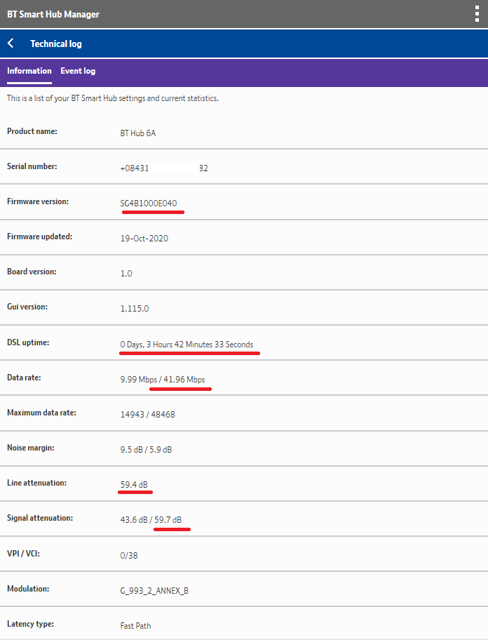

ok, so my Sync speed went upto 41+ as was posted earlier, and was stable for about 6 weeks. Then the upgrade happened, and the  sync speed dropped to 37. At the time of the upgrade I could see 2 restarts of the router from the logs (whether linked or not I cant be sure as that fell on the  routine 14 day restart schedule.). But after the upgrade the line attenuation went up by about 15 db , but the noise margin was about 6.9 or so, so I assumed, after the next restart the line would come back with 41+ sync speed as it has happened in the past. But today it restarted on schedule, and the speed has not recovered. I understand that BT does not cap speeds. But it certainly seems suspicious that at one time my speed - again, I am always referring to the sync speed on the router. dropped somehow to 37 and the BT database has the speed range of my line dropped from VDSL Range-A from 50/32.8 to  40/30.7. So one failure I assume cannot change the database overnight, so why in my case the speed range dropped overnight ? The 50/32.8 was there since I signed upto BT few years ago. I have has occasional issues, and early 2019, I had a engineer visit who fixed my issues and the line test then showed ~44 Mbps which is what I was getting until the current saga. As you can see from my previous posts even though the system database was showing that my line was on 40/30.7 I was getting sync speeds of ~42 for over 6 weeks. I have complained to BT and I have an engineer visit arranged for tomorrow the 4th, I hope it will fixed.
But I also have a nagging suspicion that the engineer will refer to the database and tell me that is what my line is designed for (this is what I was told in 2019 and I accepted that). If it is anything other than my fault then I would expect BT to restore my speeds to what the line is capable of.

Aah, sorry I was not aware of that subtle difference, I thought they were both BT but separate companies. Anyway, back to the issue with my line. The engineer is supposed to visit today evening. However, early this morning, there was a restart of my connection initiated by ACS, and the speed went back to 42MB, which I think is reasonably close to the speed that I would have expected to get. It shows there was possibly some reconfiguration done at the broadband network (it's an assumption based on what I saw and not anything else) and not the physical line.  Strange though all the other values seems the same including the attenuation that has gone up 15dB; makes you wonder what that figure does.
I think I will cancel the field engineer visit, keep him safe :). I do not believe this is a physical line issue
Thanks for all your advices and help
Getting actual 42 whereas the database says 40. I hope now this will be updated as well.Getting actual 42 whereas the database says 40. I hope now this will be updated as well.Screenshot_2020-11-04 Information.png
