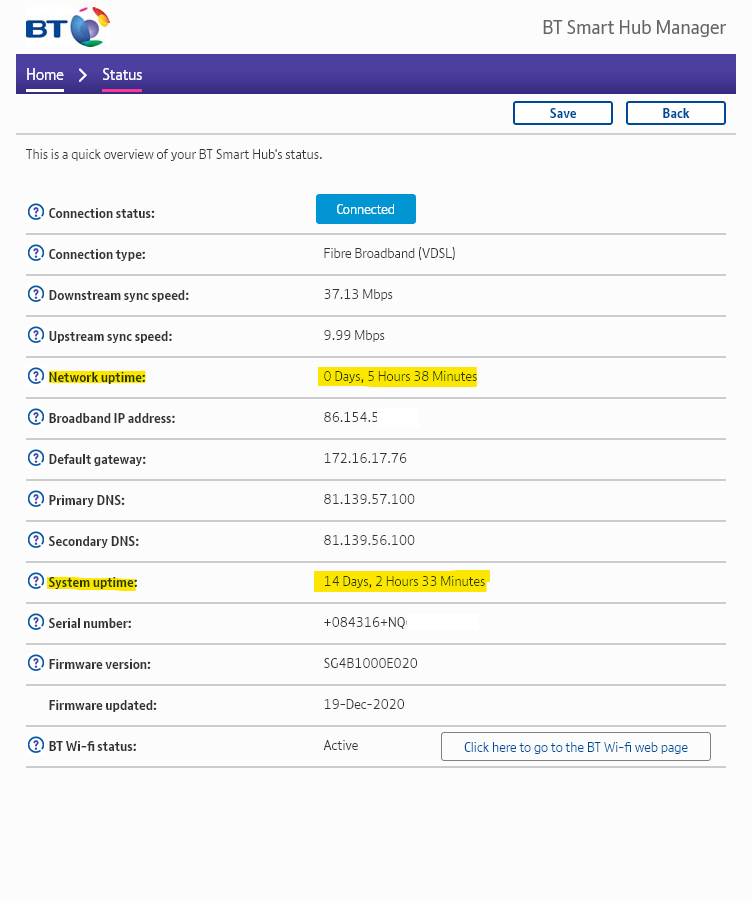

I have not started a new topic because the issue I have seems to be a recurrence of a previous problem. If you think I should, please can you let me know, and I can do that. Thanks
This seems to be a recurring issue now, after 4 months of stable speeds at 41+ Mbps, suddenly the speed dropped to 37.13 again, without doing anything at my end. In fact if the past data is looked at, after every 14 day restarts, the speed was consistently improving although by a very small margin, but trend was upwards. Here are the values which I recorded (since that time up until yesterday.
41.415
41.648
41.855
41.648
41.338
41.984

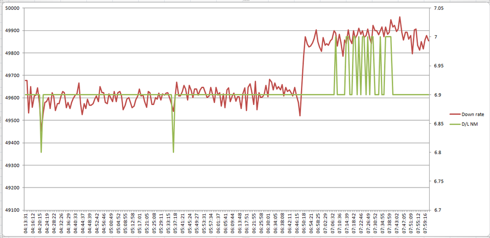

I have done the standard checks, quiet line test - done and no noise. Have no spurs on the telephone line, and router is connected at the master socket. Seems like something at the BT side. If it is a temporary test or something BT is doing I would expect them to let us know, but have heard nothing. But this seems a bit odd to suddenly drop speed by 5 MB, wonder if I complain where should I do this. (broadband or line fault) ? I have also done a quick check of the maximum data rate which I have seen in the past is a very dynamic value, for approx 4 Hours, and cant see any major issue there either from previous. So why would just the connected speed drop ?
  Screenshot_2021-02-28 Information.pngScreenshot_2021-02-28 BT Broadband.pngScreenshot_2021-02-28 Basic - Status.pngMaximum downlink data rate &  Noise Margin (4 hours this morning)Maximum downlink data rate & Noise Margin (4 hours this morning)

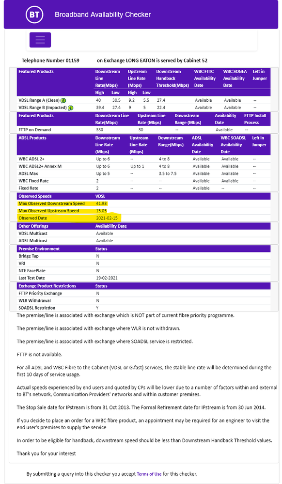

I have the speeds monitored over last 2 days and I am unable to find anything that would cause a problem with the D/L speed that it has to drop 5 Mbps. The max rate on my line remains where it has been seen in the past but the NM has increased and actual connected speed dropped. Is this a mechanism to drop the speed to fit within the BT database which has dropped and shows downstream line rate maximum of 40 , when clearly my line can handle better ?Even that shows tested data at 42 Mbps
As I said before last time this happened I booked and engineer visit as advised by BT support and the day of the engineer visit the rate mysteriously recovered.  Not sure if this is a broadband issue or a line issue. Can anyone help me understand who to complain to ?

It is probably just simply another service has been provided to a customer and the resultant crosstalk has dropped your speed. DLM has absolutely no knowledge of any database and just automatically adjusts your line to give the best stable speed.
