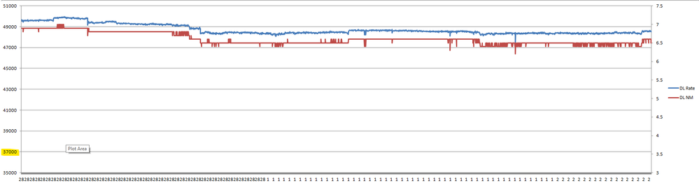

I have the speeds monitored over last 2 days and I am unable to find anything that would cause a problem with the D/L speed that it has to drop 5 Mbps. The max rate on my line remains where it has been seen in the past but the NM has increased and actual connected speed dropped. Is this a mechanism to drop the speed to fit within the BT database which has dropped and shows downstream line rate maximum of 40 , when clearly my line can handle better ?Even that shows tested data at 42 Mbps
As I said before last time this happened I booked and engineer visit as advised by BT support and the day of the engineer visit the rate mysteriously recovered.  Not sure if this is a broadband issue or a line issue. Can anyone help me understand who to complain to ?

It is probably just simply another service has been provided to a customer and the resultant crosstalk has dropped your speed. DLM has absolutely no knowledge of any database and just automatically adjusts your line to give the best stable speed.

@licquoriceToday I made a complaint to BT, and they booked an engineer visit. However a bit later, I had a call from BT who said they tested my line and has found no faults including crosstalk. I did tell her about the feedback I had from the community and she confirmed that there is no cross talk on my line. So if that is true then this drop in speed is suspicious and maybe linked to some other issue and maybe fixable remotely like last time, but that BT needs to check; as to what was done last time.
Not sure if there is anything more I could do. At this time none of this makes sense. I have a measurement of the line data rate that is running every 2 minutes capturing the NM and Max. data rate, and can't really see an issue there except that the NM is higher at around 7

If your noise margin is at 7dB, DLM thinks there is a problem with your line.
BT wouldn't have been able to test for crosstalk, so not sure why the operative said that they had, unless they meant no crossed line which is something entirely different.
