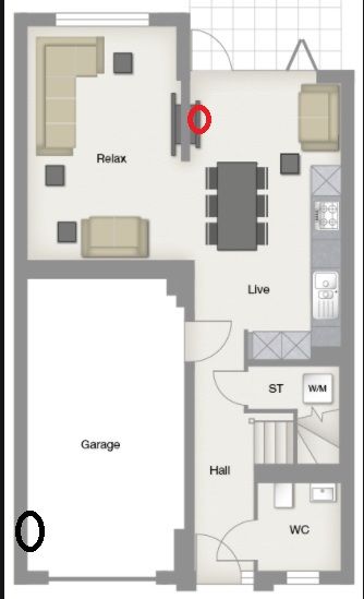

Hi all,
Looking for advice.  I moved into a new build 3 yrs ago, and for some reason the model of house I moved into had its master socket installed in the internal garage basically isolating the router off from the rest of the home and removing the ability to place it in its most optimal position in the actual living space of the home.  I've included an example floor plan to illustrate with master location circled in black.
As you would imagine, the internal door to the garage is a security/fire door and trying to run the router from any extension results in a drop in performance.
I currently have the complete wi-fi setup to extend the signal, but can't help thinking i could be getting more WI-FI performance from the router if the master socket was in a different room, say the living room where there is currently an extension socket (circled in red).  Also, i don't think the signal from router to discs is as good as it can be.  I'm using a powerline adapter for the you view box as requires enet, but rather than having extenders/disks etc. plugged in everywhere, I'd rather just have the master socket in an ideal location.
So, basically, looking for advice into whether it would be worth forking out the cash to move the master socket, and if so, how do i go about arranging this from BT and what are the likely costs.
thanks

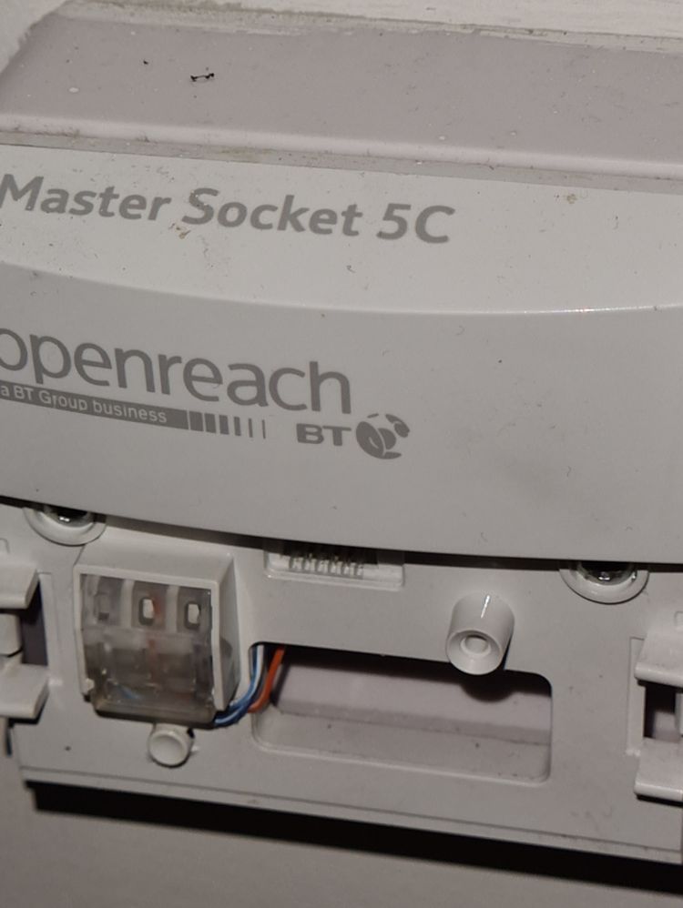

So my setup has no external cables, everything (cabling) for the master 5c is fed into back of the plate.  The blue clip in the pictures is clear on mine but you see no wires at all.   The mk 4 just clips on again with no wiring.

the newer sockets the extension connection is clear with terminals 5,3,2  the data extension connection is 2 terminals on back of detachable faceplate
so where is the extension wiring in the master feeding your extension sockets in your home?

Tried plugging into extension, not great.  I just spotted the wires 20201030_135552.jpg

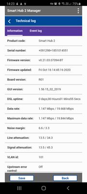

Connected up per diagram but d/l speed dropped and upload awful.
 data rate before was 25 / 2.6
