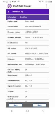

Hi
I recently moved to bt fibre 2 but my speeds are capped at fibre 1, I have tried numerous attempts to get this resolved through customer service to no avail.  So as a last ditch attempt I'm hoping one of the mods can sort this for me.
Thanks

your attainable speed is only 58mb whereas from dslchecker I would expect that to be a lot higher as attainable is not affected by the package your choose.  Have you tried using test socket with a filter so see if that changes connection or attainable speed?

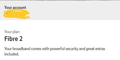

can you check MYBT and see what package it shows you to be on

It looks like there are 2 separate things going on here. You are on Fibre1 as your upload speed has been capped at 10Mbs but there also seems to be a fault as your download speed is below the Fibre1 cap (so Fibre2 wouldn't increase it it) although the checker shows you you should be getting closer to 80Mbs. The other oddity is that your max upload speed is very high (above even Fibre 2 cap) but your your max download speed is very low in comparison.
