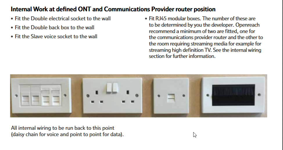

@Davemarsden132  are there no wall/surface mounted plugs in the cupboard or the house?  I don't mean electrical.
Have a look at Page 2 of this from Openreach - https://www.openreach.com/content/dam/openreach/openreach-dam-files/images/fibre-broadband/fibre-for...
The section with the light green dotted lines...
How a good developer does it.

Re: Moving FTTP
The developer was  supposed to put RJ45 sockets in every room. But instead they put Phone Line's in every room in a loop system -_-..... basically i can have a telephone in every single room! PHONES EVERYWHERE
But the internet, yeah cant do that.... haha
