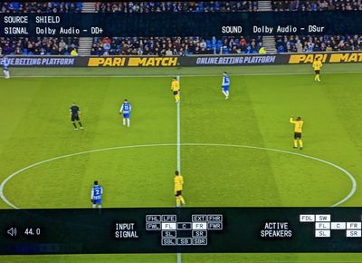

I tried watching the Brighton v Chelsea game on Ultimate and again only 2.0 sound is being picked up by my receiver.  That said it does detect a Dolby Digital+ signal but only two speakers active.
Here is the information from my receiver - see 2/0/.0 being listed and the input signal.

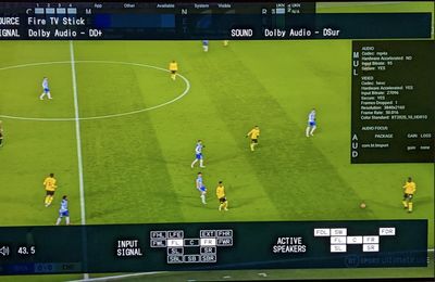

It looks exactly the same when streaming via the Fire TV 4K.

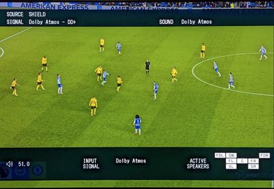

However, interestingly when using Chromecast from my phone to the same Nvidia Shield, a proper Dolby Atmos signal is detected.  It just seems to be the native apps where I'm struggling:
Thanks for your help.

When I switched over to the game on Ultimate it was the same issue as above.  However about 80 minutes in I quit the app and reloaded as I was having streaming issues and lo and behold - the Atmos stream appeared!
