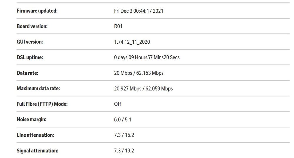

btstats.JPGHeres my current router stats. I think g.inp is now enabled as my speed is stable at faster than my max attainable speed?
That's nothing to do with G.Inp. Your actual speed doesn't vary unless a resync occurs but your max attainable fluctuates continuously as your line conditions vary and can be faster or slower than actual.
DLM may increase your speed further if it thinks your line is stable enough to reduce your SNRM to 3dB

hi, Yes I have seen that my max attainable speed goes up and down, just with refreshing the router page I can see that. So how long you think I need to be stable at my current speed before the DLM decides to push my speed up or down? It's been 8 days and no disconnects?

Its already moved it from 6dB to 5dB, but that may be as far as it thinks your line will cope with. You'll just have to wait and see what happens I'm afraid.
