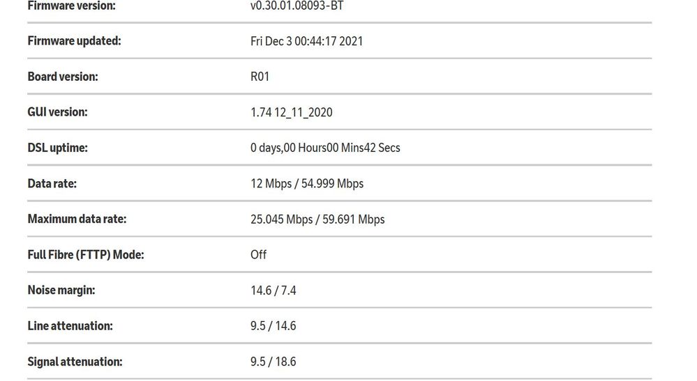

I did the quiet line test and cant hear anything. I only rebooted my router once the speed had dropped to 54.999 to see if it was the router playing up, I wont reboot it again. I was told last time that its best to just leave it to see if my original speed came back, it didn't. So does it look like im stuck with 54.99 now? Also isn't a 7.5 noise margin high? I remember when i was like 3.5 a few years ago.

54.999 Mbps - This stat looks locked at that speed. I am on fibre 2 but do you think ive been given fibre 1 speed for some reason? Can bt please run a line test. I'm quite anoyed about losing so much speed.

you you had been moved to fibre 1 then up speed would be restricted to 10mb and it is at 12mb
have you tried using the test socket with a filter to see if that helps your connection and post new stats - especially attainable speed which is currently only 59mb

I will try the test socket now, Could a mod on here do a DLM reset would that help?

from your stats there is nothing to suggest a DLM reset is needed - normally after a fault has been found with engineer visit

These stats are plugged into the test socket, the stats suggest there was a firmware update last night, could this effect it? Is there any way for a mod to do a line test for me at least?

Can a mod not reset it so my line target like 3.5?

A DLM reset won't give you a target of 3.5 and cannot be forced.

Ok, but does whats happened to my stats suggest theres a fault on my line somewhere. Is a 7.5 noise margin normal?

If you think there is a fault on your line then report it to CS 150 and get engineer visit
