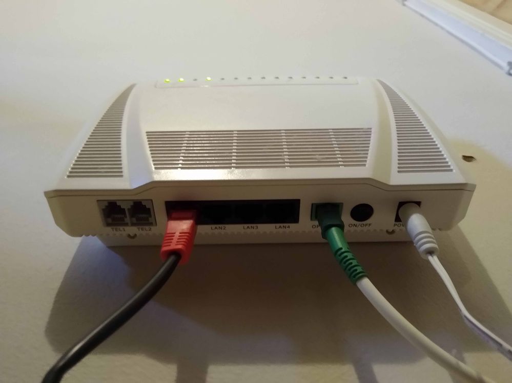

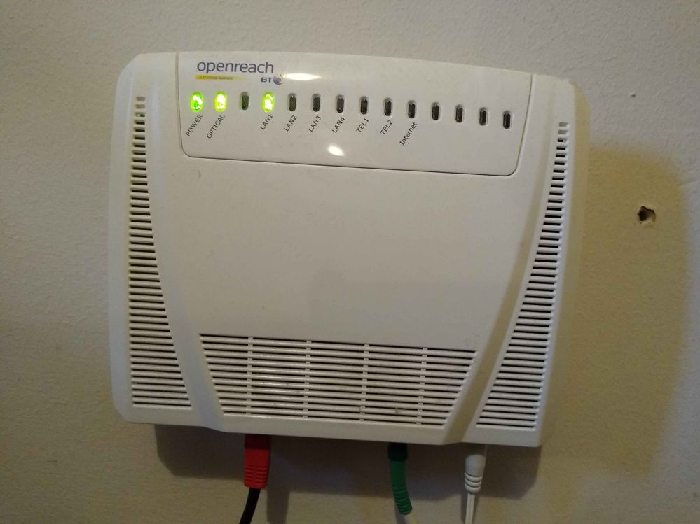

Sorry, I assumed the white box in the wall was an ONT.  Here's some photos of the setup. Solid green lights on power, optical and Lan1bt01.jpgbt02.jpgbt03.jpg

@sjm1
When did BT tell you your service was activated, as you cannot assume an existing connection will work?
What service did you order from BT Retail?
You have an FTTP connection which has probably not yet been configured, but you have everything connected up correctly.

Not seen an ONT like that before but I suspect the 'Internet' LED would be lit if the service was activated.
Perhaps @Starwire might be along to enlighten us, if you'll forgive the pun.

That’s an ECI ONT. Very rare.
I believe Openreach only used ECI in the original FTTP Trial Areas before switching to Huawei and then subsequently Nokia.
Personally I wouldn’t want to be on ECI, it’s antiquated and the speeds are limited. Last I heard they were supposed to be removing ECI Head Ends in favour of Nokia.
