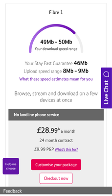

However, since BT have changed their promo's and rebranded the service again they moved me over to Fibre 1.  although solid and reliable I now only get a max download speed of just over 40Mbps yet the price is still eye wateringly high and has increased year on year.
If I try to upgrade my package it simply doesn't offer Fibre 2 as an option.  If I put in a generic postcode for where I live rather than landline number it again only says Fibre 1 is available?
My question is how come I have broadband nearly half the speed of what it was half a decade ago with no faster options available?  Is it just that people have swamped the exchange and its no longer possible?

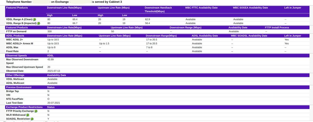

I've done a broadband speed check (hopefully) attached and it seems to me to be reporting that the service speeds of Fibre 2 should be possible?

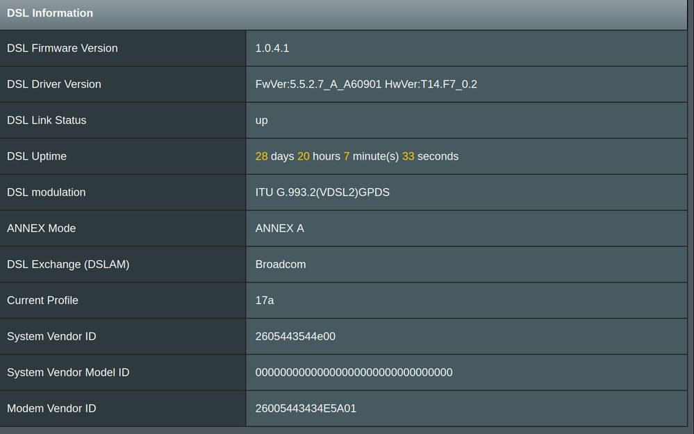

Can you post stats from your hub/router

From dslchecker your up speed was20mb which suggests you are already on fibre 2

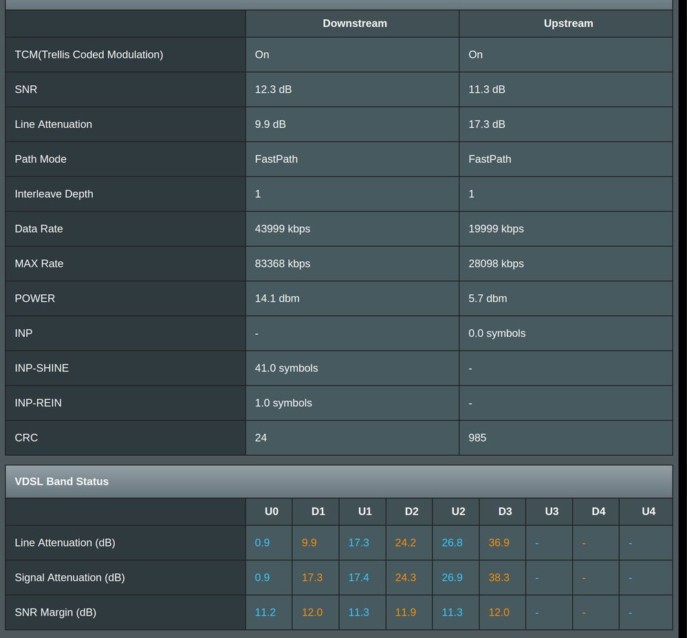

I've attached details from router.   Can see max rate is over 80.  I do see some CRC errors reported but again as I said previously they have me on the 1 package anyway and don't even state the Fibre 2 being available.

From what you have posted I think you previously had some connection problems which resulted in the DLM putting your connection into a banded  profile which explains why you have what appears to be a fixed connection speed of 44mb and up speed of 20mb

Also one important point. If this is a banded profile problem related to me how come if I go to BT anonymously and lie about my address giving any other one in the village I live in I'm never offered Fibre 2 package?  Only ever Fibre 1?  Faster option not even mentioned.  Can't be whole town wide problem?

The reason why you aren't offered the 80mbs package is because you are already on it. I think you may have got confused when they moved everyone over to Halo 1 and thought that was related to your speed (which it isn't)
It looks like you've got a line problem and the DLM has lowered your speed in order to make it more stable.

as you have 28 days stable connection and still stuck in banded profile I have asked mods to see if they can help you.  you are still on fibre 2 just speed restricted by DLM
this may help   FTTC DLM - What it is & How it works - Plusnet Community

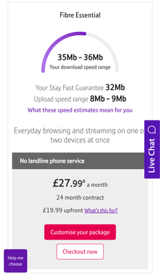

Like I say the thing that threw me is if I search for broadband deals  and put in a different address on the road I am clearly still offered only two options:
Fibre Essential & Fibre 1 with the lower upload / download speed?  That seems a bit odd?
