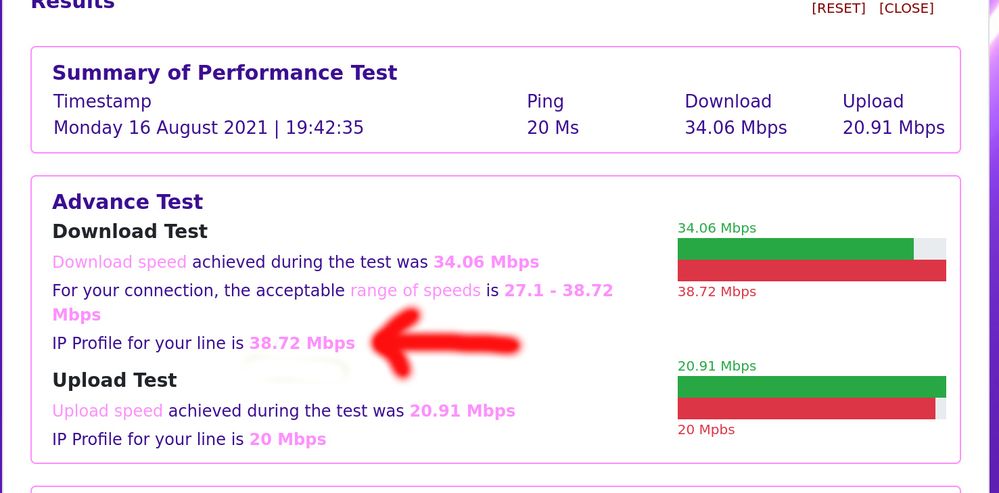

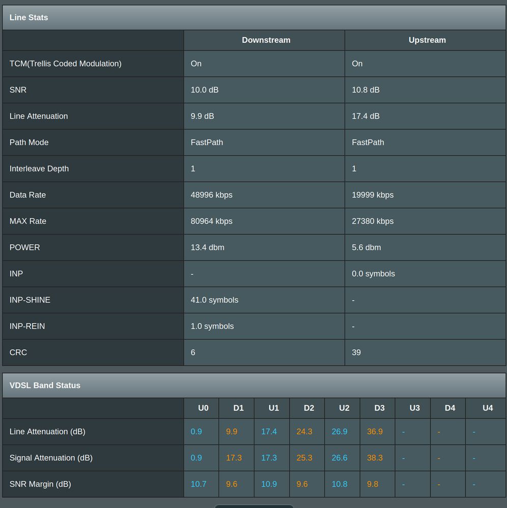

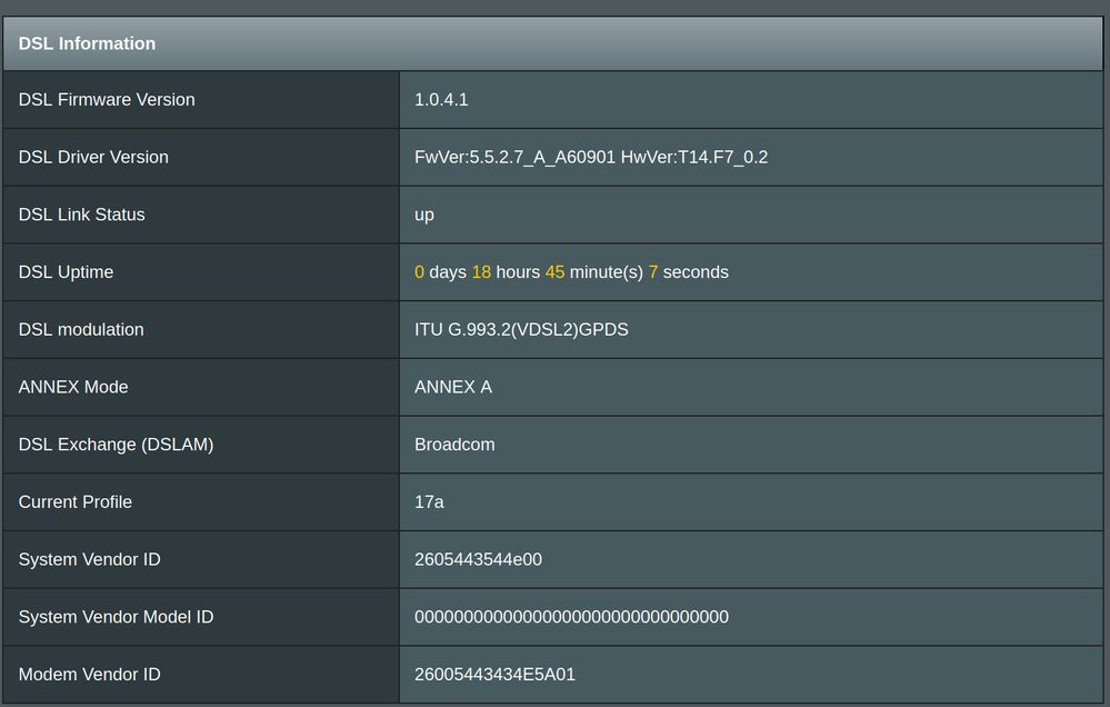

So we are now over 2 weeks in since first asking about this and still no resolution.
When they finally received my PM I was told they had done a DLM reset on the line and they could see it was syncing at a higher rate of high 60's.  Unfortunately that is just not true and nothing has changed.
Running BT wholesale speed test on a wired PC direct into router in master socket with nothing else connected to the network, again max I could get was still only 37Mbps.   The interesting this is this speed test reports that the IP profile of my line is only 38.72Mbps and has everytime I have run it before and after the reset.  Seems a bit of a coincidence this is the highest rate I can achieve - There has got to be some other limit in place that this test is picking up that they are missing causing the slowdown.
On top of all this I notice that since their reset was run my DSL connection now resets over night around midnight / 1 am everyday and it never used to do that!
I have PM'd this info to the admin to be told he's not away but someone else will take it up.  That was 7 days ago and heard nothing since!
It really shouldn't be this hard.  I'm paying for a higher connection rate I haven't had for months but don't see any refund coming or any help to sort it out.
Attached here reports from todays tests.
It really shouldn't be this hard and need this much faffing on the customers behalf.

The speeds you are quoting are download speeds but all speeds quoted by BT are connection speeds to your router.   No ISP guarantees download speed
Was  the notification you received saying that a DLM reset had been done come from the mods or elsewhere?
From the stats you have posted you are on fibre 2 but you are again in  a banded profile.  Previously you were in 44mb band but now at 49mb band.  Another  DLM reset is pointless until you can get a stable connection so maybe you need engineer visit
