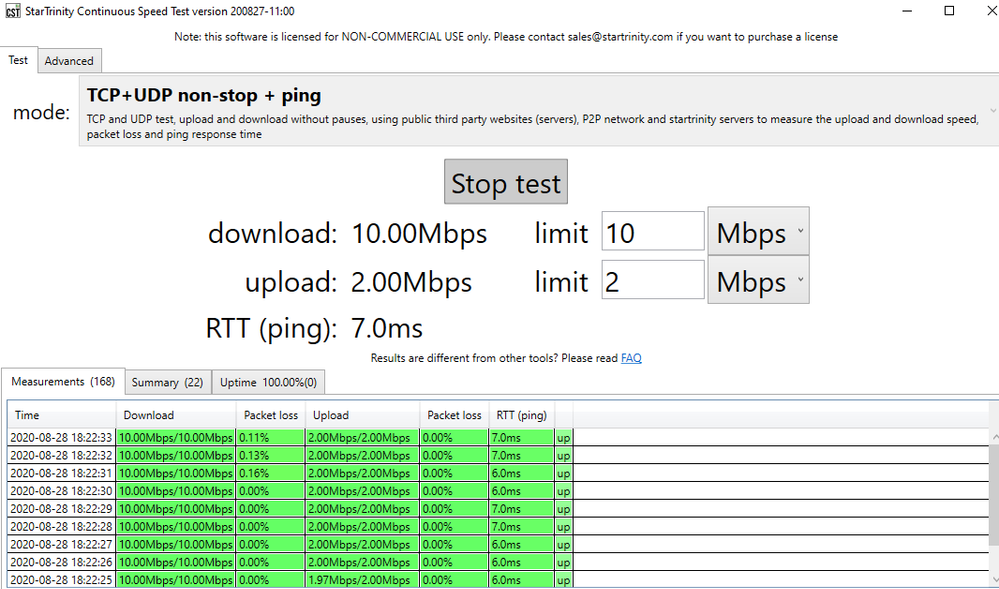

Another update, I had the Openreach engineer visit, the line was checked and came back all good. The mods NeilO, is not giving up though and has now got another team to look into this and they are monitoring the throughput on my line for 7 days to try and work out where the packet loss is coming from. I keep suspecting my own PC, but then I get the same results on my phone, at the same time and again, it's only at peak times.
I'm starting to suspect the FTTC cabinet fibre link capacity to the exchange, I know Openreach are supposed to monitor this all the time, but it is strange that I had the problem with TalkTalk also. I have no idea if they use 1GBs links to each port card or 10Gbs, but given how much people use Netflix etc, I could see how a 1GBs link could get saturated at peak times.

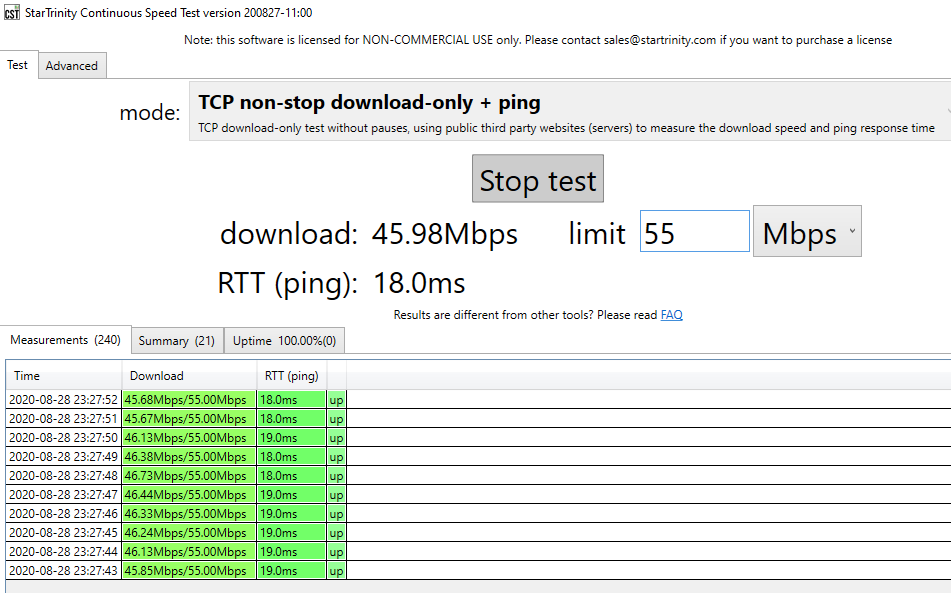

I found a program called StartTrinity continuous speed test. it claims to continually download/upload to various servers to monitor packetloss and ping.
You can set a limit on the bandwidth. So at first I set it to 10mb/2mb and I got no problems:

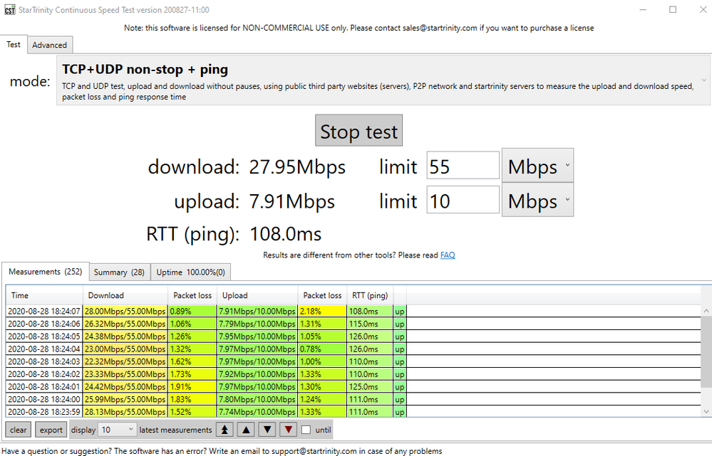

Then I set the limit to what my sync speed is 55mb/10mb, and these are the current results showing the packet loss and high ping:
It does seem as though the packet loss is causing the TCP connection to throttle itself back to maintain a stable speed of 25mb ish. This at about half 6pm. I can only show you screenshots, but I've had it running for about 20minutes and I can see the packetloss jump around from 0.10 to over 2% and the speed reflects the amount of packetloss.

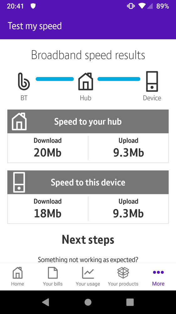

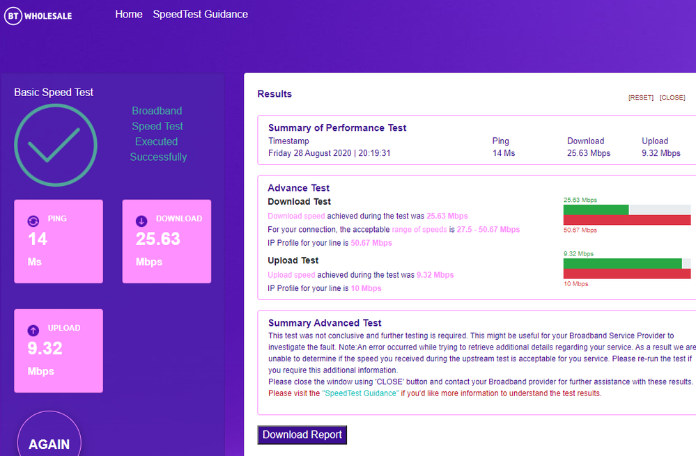

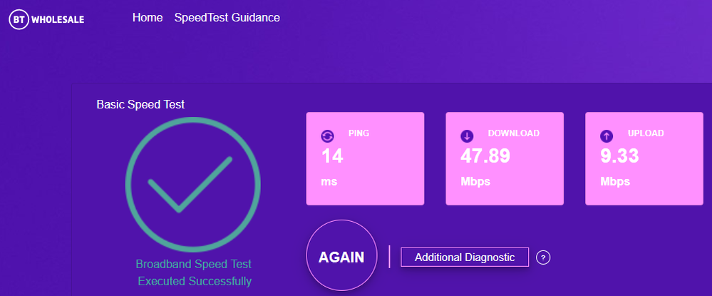

The BT tests from tonight:
6,204 Views

After some further digging I found https://my.btwholesale.com/pages/static/products-services/broadband.htm and it does seem as though there is some kind of minimum throughput SLA, oddly enough the minimum being 20mb. I also found an old 2014 WBC FTTC handbook from BT Wholesale, with a chart of the minimum throughput SLA options, depending on package, with 20mb being their minimum best effort, moving up to 60mb on an elevated package.

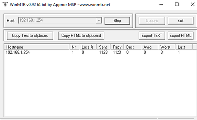

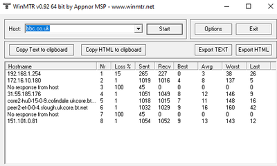

I used WinMTR tonight to try and figure out where the start of the problems is. At first I thought it was my router, as seen in this screenshot:
So I double checked and pinged the router itself and got:
I found out the next hop in the chain is the "This is the address for the network element that assigns your BT Smart Hub an IP address." So I'm guesssing that is the DSLAM/BRAS in the FTTC cabinet and it's there that the latency shoots up and causes slow packets, that I'm assuming is due to bufferbloat. It does support my idea that this is a contention problem with the FTTC cabinet at peak times, rather than the BT exchange, along with the BT data of no congestion issues at the exchange. Either the cabinet is completely full and BT can't order any more bandwidth for it, or they need to. If that can't be done then they need to get Openreach to upgrade the fibre links to 10g to support more bandwidth. I could be wrong and that IP may be the exchange edge router, but it has it in my hub admin with that description and I'm pretty sure it is the DSLAM that creates the WAN IP. The reason my PC reports lost packets is because of the latency caused by the bufferbloat, it only waits so long and it then slows the TCP connection, as it should to keep it stable.
BT could also try moving me to a different line card, although that is hit or miss.
Is there any way for BT staff to find out what bandwidth the cabinet has to the exchange? Is it 1g or 10g? If it's 1g, I can understand there being contention, especially with a full cabinet, if it's 10g, or enough not to cause problems, then I must be on one hell of a busy line card, or there is an issue with the DSLAM itself and Openreach need to be made aware, as they are suppose to monitor them though, I'm going to take a guess and say it's BT that doesn't have enough bandwidth at the DSLAM.

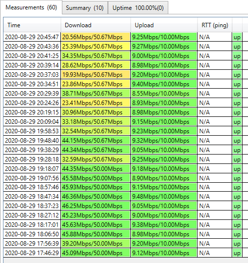

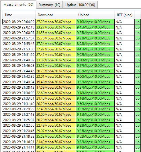

In terms of speed measurements, tonight wasn't as bad as Friday but you can see where it starts:
I actually used 10 TCP connections/sockets to reach those speeds, more than most normal speed testers, as I wanted to fully saturate the link.

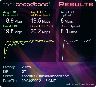

Here is a ThinkBroadband test:
1598735774878742355
