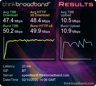

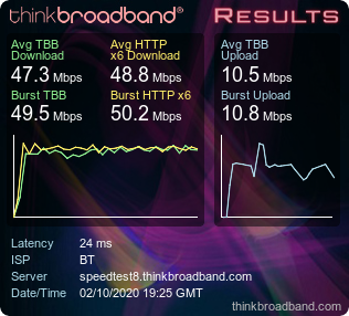

Here are some speed tests (The only limiting factor now seems to be the Fibre1 package itself):
1601647579701895355
1601666719354635855
So all good in the end and I hope this thread will help both customers and the mod team in the future and also save BT some money on extra engineer visits. Hopefully in the future there will be some more careful monitoring of the cabinets and faster upgrade times, as well as closer communication between ISP's and Openreach about the cabinet bandwidth capacity at peak times. Thank you to the mod team also for keeping track of everything and making sure the issue was fixed.
