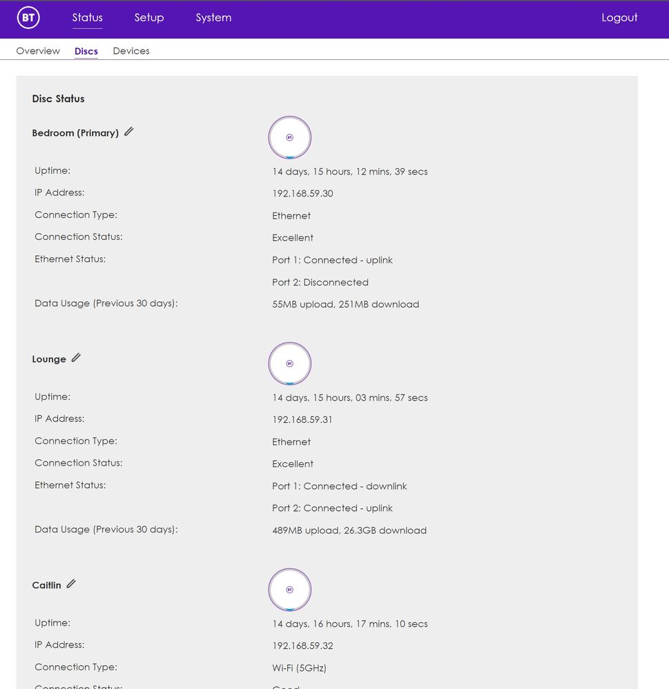

I have just clarified with MurrayB a few points regarding my setup that BT requested.
Still going strong here 14 days uptime now.
