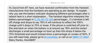

Hi @SteveR1260- I've just come across this thread and am having the same battery issue with four Advanced Handsets.  In my case it never adjusts the status from full charge unless I switch the handset off and on again.  I did raise it with BT but its been very hard to get anyone to take it seriously.  I did eventually get it referred to a product 'specialist' who texted me a response which missed the point completely.  It gave me no way of getting back to the sender to put right his misunderstanding.  I've attached the text.  Did you find a solution for your problem?  I did reset the handsets as suggested to no avail.  I'm sure the firmware needs an update but odd if its behaving OK for other users.

I have since discovered that my Essential handsets have the same problem with the battery meter always showing 100%.  I had thought that they just had very good battery life but another issue caused me to reboot them and they both dropped to 25% or less from full.  I rebooted them every day for a week  and it was obvious that the meter only refreshes on a reboot, it stays on 100% otherwise.
BT's reply may be the theory but it certainly doesn't happen in reality.
