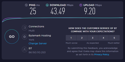

Hi Keith,
I have done these and will see how it gets on.
For reference, these are the speeds i am getting.
Thanks
Clark
