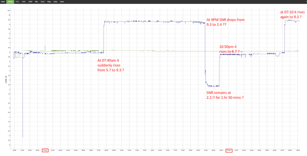

hi guys.
 I wanted to know if anyone can advise on a solution for a problem i have with BT FTTC (Infinity 2 it was known as).
I use a Zyxel VMG8324-B10A router (in bridged mode) as a modem. and an Asus GT-AX11000 router.  Im on FTTC and Cabinet is a Huawei i believe, having looked it up.
Every day my line speed  will rise and fall for no apparent reason on the Zyxel (also happens with BT Openreach modem). Also, Each day my (DOWN ONLY) SNR will sits stable (at around 5.5) until around 7:30 am - 8:00 am when it jumps up to 9.2 ?? it does this every day, and reduces again around 9pm to normal.  it can drop as low as 2.2 (but briefly ? i.e. an hour or so) - (see screenshot)
What could cause such a sudden SNR increase and decrease ? And, what could be causing my dropouts ? (let me know if you need any additional data for diagnosis)
thanks
Occasionally i monitor line stats from my Zyxel modem, here is a days worth of SNR behaving badly!
SNR-WTF

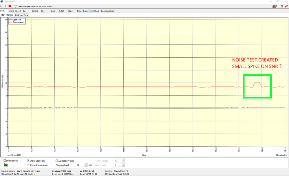

ok, i rang home and asked the missus to do the noise test  (with faceplate attached) using an old wired phone.
she says the line is crystal clear , no noise at all. (this was tested while the SNR value is at it peak, 9.3 SNR)
Oddly, when i looked at the stats after the noise test was done, the was a slight SNR increase (i.e. went up to 10 SNR) while it was being noise-tested ?
snr-s-PIKE
what's my next move ?
thanks
5,973 Views
Message 7 of 39
Re: SNR like a roller-coaster ? - help
ok, no noise on line as per earlier post and graph (one little spike occurred on eth SNR while the noise test was being done).

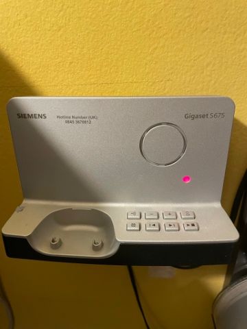

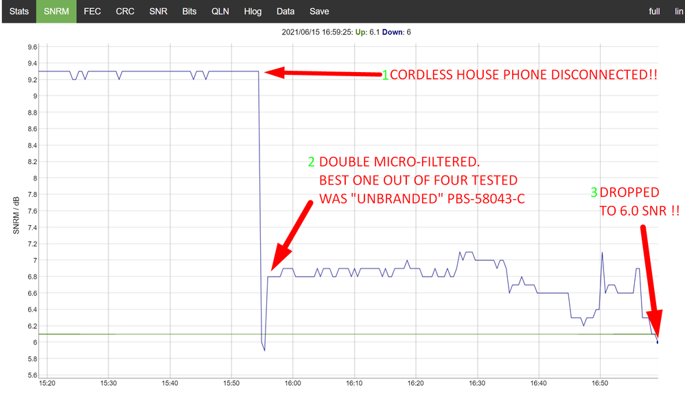

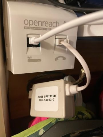

OK GUYS , I have just had a bit of a eureka!! moment.... hopefully this will help others....
The one thing i never tested was our cordless house phone (duh!).
...and so what I did was , just for fun, to double micro-filter the phone-line socket (but leaving the VDSL socket untouched).
and guess what, immediately  the SNR dropped quite dramatically!!
SNR went from 9.3 down to 6.0 !!
For double-micro-filtering, I tried 4 different micro-filters, each having mixed results. The best one turned out to be an 'unbranded' type with marked with only, ADSL SPLITTER - PBS-58043-C
This was the one that worked in reducing SNR the most. And yes, the phone still works fine...
just need to see if i can tweak it a little more to find that 2.8 SNR sweetspot that I got for 2 hours....
SNR Graph after double-filtering with 4 different microfilters....
The phone base causing the problem!! (now heading for the recycle bin)...

Double microfiltered phone socket

I suspect it was more the faceplate not being seated correctly and changing filters has resolved it. Those faceplates are notorious for that.
