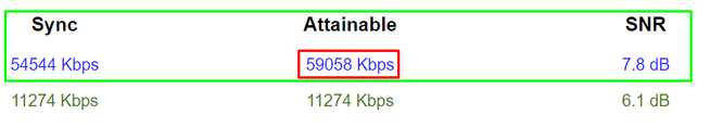

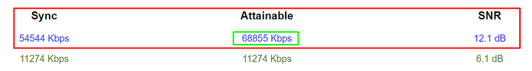

Given that, from my stats/graphs, i have to assume that 12.1 SNR is "good"
and 7.8 SNR ..is bad... ?
....since the Attainable value is higher, correct ?

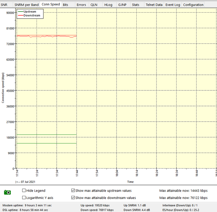

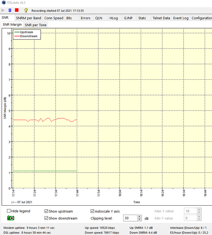

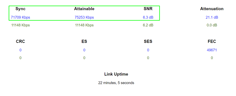

just updated the custom firmware on my Zyxel , which updates the modem from x1 to x6 - later adsl_phy.bin
Sync is much better and both SNR#s are sitting around 6.2db
i have a funny feeling the old firmware was possibly showing SNRM as "inverted" on the graph/stats ?
this does look better though;

Message 35 of 39
Re: SNR like a roller-coaster ? - help
That looks better

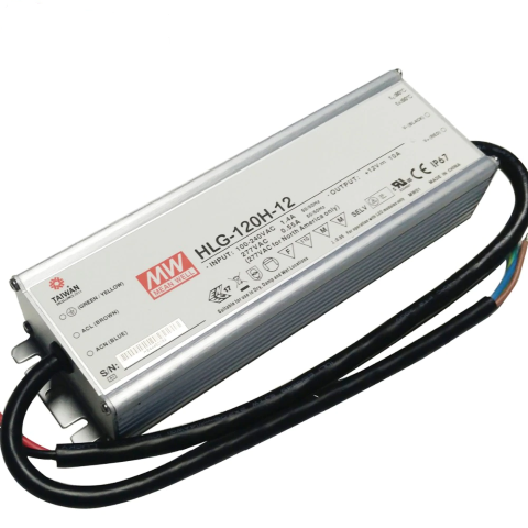

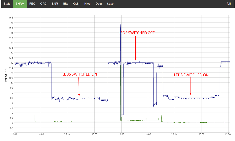

all my interference issues were resolved after getting rid of the cheap Chinese LED drivers, and replacing them with a "properly" Made in Taiwan LED Driver, namely a... Mean Well HLG-120H-12 LED Driver. Expensive, but 100% bulletproof when it comes to producing absolute zero RFI/EMI.... all is good now with my Broadband.

it made no difference where I put the first type of Unbranded Chinese drivers. the very fact they were connected to the mains at all, caused the RFI/EMI.
Only when I replaced them with the Mean Well 120w driver, did it get resolved.
One of my earlier posts illustrates what was happening to the modem/line once the drivers powered up....(see graph below).
Dear knows what other problems they were causing...
Given that I bought them from Aliexpress, it was no surprise really they caused hassle....
I can't praise the Mean Well driver brand enough. Not the slightest bit of interference from them. Well worth the extra £'s.
