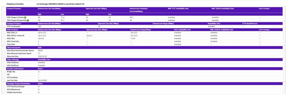

Have also attached the BT Wholesale results

Have you tried using the test socket with a filter to see in that improves connection speed which is lower than the expected range according to dslchecker
