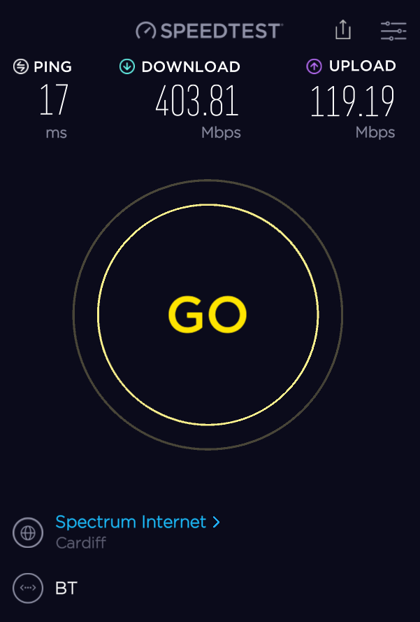

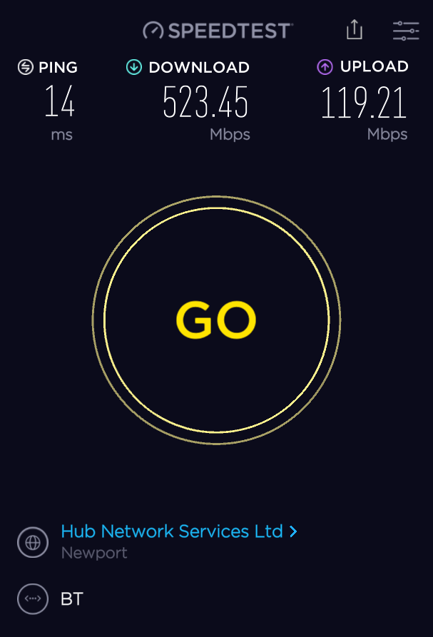

I’m on full fibre 900 and only really achieving 400/500 tops even when connected with a PC directly into the ONT. I’ve tried raising it through support but not been very successful getting help with the issue.
I upgraded earlier in the year from another ftth service, although I don’t recall now which one or if i was getting full speed on that service.  But since upgrading I haven’t been able to get faster than 500, and sometimes its as low as 350.
I have my own router and in fact tried a few different ones with a range of different config types but hasn’t made any difference. In the sprit of openness a BT home technician came and tested the BT router and concluded it was reporting higher speeds and within the SLA. That was a bit frustrating because its not as demonstrated with my laptop connected directly to the ONT.
If anyone has ideas on something i could try or how i could better diagnose the problem?

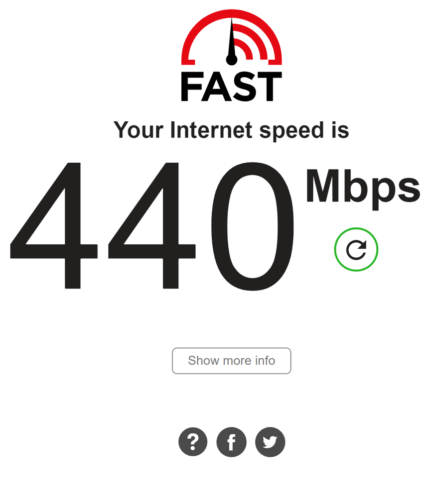

Also getting very slow FTTP speeds, fast.com showing about 350-450Mbps Router and Switches are both 1Gbps, so usually get around 900Mbps.
PC Specs are fine, 5900X, 2.5Gbps LAN.

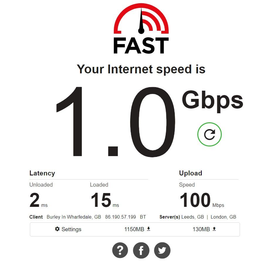

It's bizarre most people recommend https://fast.com/ yet it seems all over the place to me. 🤔
I pay for the 900/110 package yet this tester tells me I have 1Gb most times I test it.🤣
Ookla is giving me (what I would call) a more accurate reading but check them all, that's what they are there for.😂

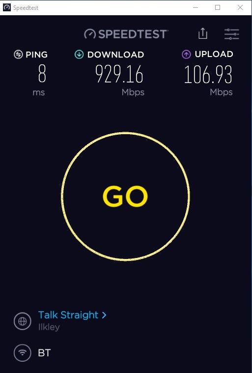

Gonna add some speed tests too.
These are usually 900Mbps+ results

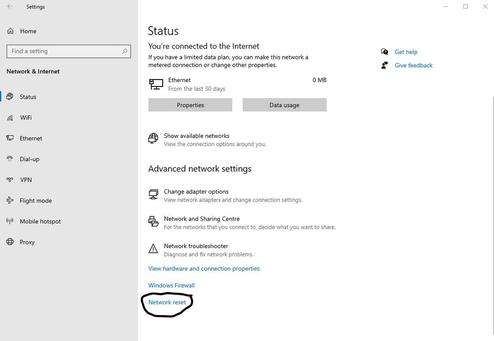

Probably not what you want to do but have you tried a complete "Network Reset" and let the computer auto configure the settings again.
That PC should whistle the 900/110 package.👍
EDIT: you posted when I was making this post. Good job. 😁
