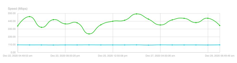

I haven’t been able to get close to that speed in reality and in fact most of the time if i monitor it is below their threshold as you can see below:

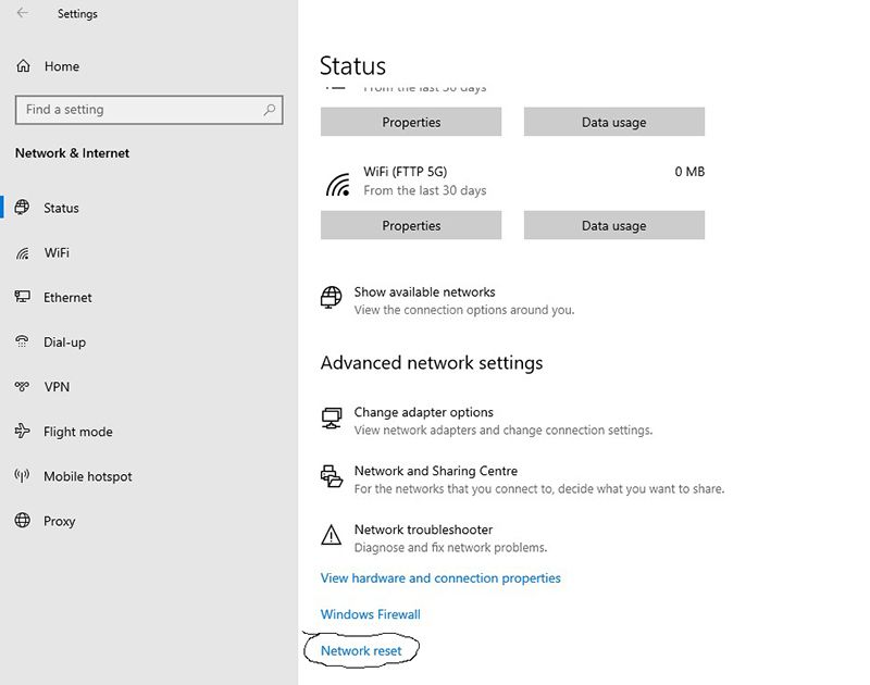

1: Apply a total reset to your network on the computer.

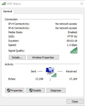

2: Check the WiFi status in the Network settings to assure you are equipped to receive such high speeds, 1.2Gbps on mine.

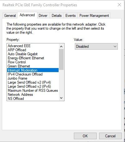

3: Disable Interrupt Moderation in the "Controller Properties"

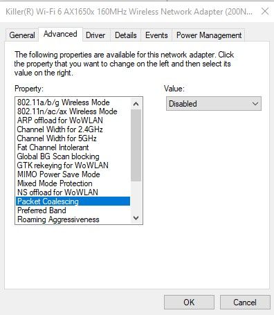

4: And finally Disable "Packet Coalescing" in your WiFi Network Adapter.
