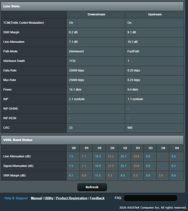

Hi @DavidM,
I'm connected not on a BT SmartHub2 I'm using a third-party router?
Also @TimCurtis please have a look down below for the router DSL log:
System Log - DSL Log
This page shows the detailed DSL status.

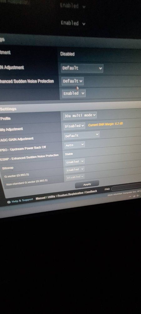

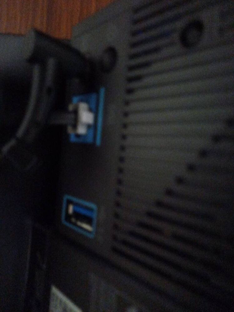

@Anonymous
Something serously wrong there.
Please post a screenshot of the settings I requested.
So the Asus is plugged into the phone socket, is it a filtered socket or one that requires a separate filter? And could you post a shot of that please.
What sort of speeds were you getting with the SH2?
Was this a new Asus or secondhand?

Hi @TimCurtis,
@TimCurtiswrote:
@Anonymous
I know it is @TimCurtis, here is a screenshot of the settings that you requested for:

The speeds that I was getting to my SmartHub 2 were 66.969mbps (download) and 20mbps (upload) here is a photo of my incoming BT Openreach socket and the back of the ASUS DSL-AC68U:
Lastly no I was bought brand new @TimCurtis 😊.

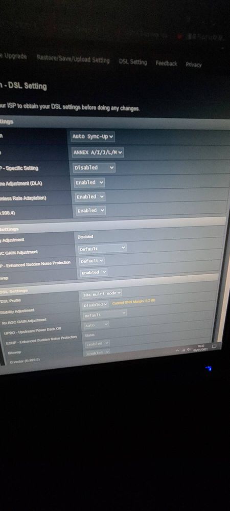

@Anonymous
I really need to see the DSL Settings screenshot not the DSL Log.

Re: Slow internet speed to ASUS DSL-AC68U
Hi again @TimCurtis,
See down below:
Is this what you meant?

@Anonymous
Your settings look fine to me, so similar to mine to make no difference.
However, in the DSL Log the power figures look all wrong.
I assume that you've not double filtered the connection and are using the same dsl cable that you were for the SH2.
I'd be inclined to reconnect the SH2 and see the stats from that, if they are now similar to those from the Asus then I'd consider a line fault to be the issue.
The incoming phone line has 2 cables and the internet can run on just one of those , albeit quite slowly. Possibly showing results similar to yours.
If the SH2 works as before and not showing such low speeds then firstly I do a full reset of the Asus and then start from scratch in the setup using the wizard. This is the guide to a full reset:- Full reset
If there's still a problem with the Asus after this then I could only conclude that it's faulty.
EDIT: Did you do a firmware update by any chance, as that might have gone wrong.
