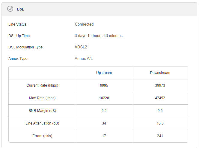

However on our return to BT (no engineer visit for either switch) we have lost a large chunk of our download sync speed.  We synced at 47 on the old BT and the Vodafone, but now on 37. I am using the same TP Link router I used prior to the switch.
Is there any way of getting that back? Will DLM adjust it over time?

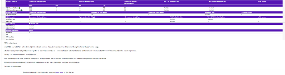

can you post router stats and also dslchecker results - leave exchange and cab

Attached are the router stats and dsl checker results.
Any ideas?
Thanks
Jeff

The dsl uptime is only 3 days is that when you originally connected router or has router been dropping connection or have you been resetting router to try and improve speed or a combination of them?

After poor connection speed with the Hub I reconnected my TP Link (5 days ago or so). One overnight drop 3 days ago as you can see and has been connected ever since.
I have deliberately not kept resetting router as I know that drives DLM crazy and is more harmful than good!
I will file the line fault and see what happens. Anything else I can try?
