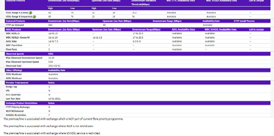

Message 3 of 10
Re: Unresolved Fault

the checker shows you are still on adsl2 and speed appear low compared to estimated range
you could upgrade to fibre and even Fibre 2 which should give connection speed about 80/20mb which would be a huge increase from your current speed
