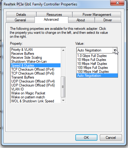

As 1000mb doesn't even appear in the options list it could possibly be a driver/NIC issue.
Here's mine for comparison.

Thank you, I will try the 100mbps thingy!

Duplex is about the link talking in both directions
Half duplex means it can only talk in one direction at a time so takes it in turn to talk backwards and forwards
Full duplex means it can talk backwards and forwards at the same time (so is faster)
Do try setting your adapter to 100 full duplex and see if that stops the ethernet disconnects
This is only the link between the PC and the smart hub, not the link between the smart hub and the internet.
How old is the PC (model number ?), and is the ethernet built in (or a usb device), it might be a driver or port problem, but we are also forgetting that you have had problems on wifi too. But lets get the ethernet link between your PC and the router stable first.

I have had it set to 100mbps Full Duplex for 2 days now... during which I've had no weird disconnecting. Keeping an eye on technical logs, etc.
If that is the solution, can you please explain why? I'm afraid it's another bandaid rather than a fix.
If that's the solution, what is the problem?

When an ethernet connection is made (and the system is set to auto negotiate), the two devices work out how fast they can make the connection. If the connection is a bit marginal for noise (bad cable, faulty socket, faulty devices, etc) then it might be able to negotiate a fast speed, but then errors on the line might change its mind and the link can 'fall back' to the slower speed. This causes a disconnection. It can then look at the line and if the 'noise' or fault goes away, it can 'fall forward' to the faster speed and cause another disconnection.
Forcing it to connect at 100mbps might stop that activity, though if the errors are bad enough it may still have problems, but at 100mbps its more resilient to noise. But that still doesn't explain why you had problems on wifi.
As to 'built in' I was thinking lap top and some you have to use a device plugged into the USB port. If the ethernet is on a card plugged into a socket on the motherboard, it might be worth replacing it as they are cheap, but ask your friend to help out as they might have some spare ones 🙂
