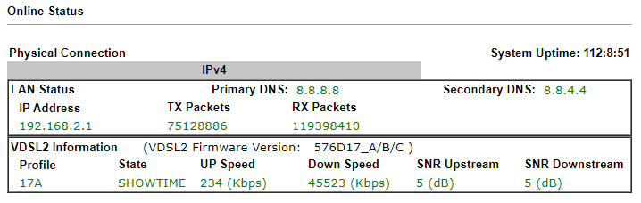

Thanks.  Here's the connection speed reported by the modem.  I can't find any info on connection speed in the router (it's an ASUS RT-AC87U) but I'll keep looking.

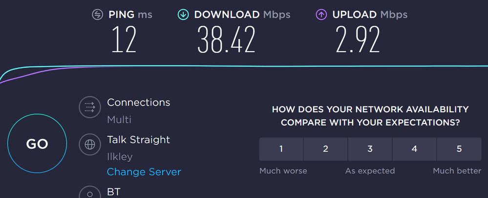

speedtest.net is also showing the same results.

Is there anywhere in stats that shows attainable speed?
have you been having connection problems with router dropping connection or trying manual reset to improve speed or maybe a combination of both
you are currently in a banded profile hence why you keep getting a connection speed of just short of 44mb

Yes I’ve been restarting the modem whenever I notice the upload speed has dropped to 266kbps as I can’t work from home with that bandwidth and restarting the modem fixes it.
While searching around this issue I did read that doing that can put you in a banded profile and that it needs to be left for 10 days, but like I say that’s not a workable solution for me while trying to work from home.  I can cope if it stays at 3/40 but when it drops to 266kbps on the upstream I have to do the restart.

Unfortunately if you continue with your restarts then hub will not recover and in fact your connection could get worse as DLM drops you to lower band to try and stabilise your line
it will take longer than 10 days stable for banding to release

Looks like I spoke too soon!  I didn't end up plugging the phone back in (I forgot), and this is still in the test socket.  Just now I noticed the internet seemed slow.  Checking in the modem I'm getting 234kbps up and down has dropped back to 45 meg.  Any further suggestions?  I'm not going to restart the modem this time, I'll just leave it and see if it recovers.
