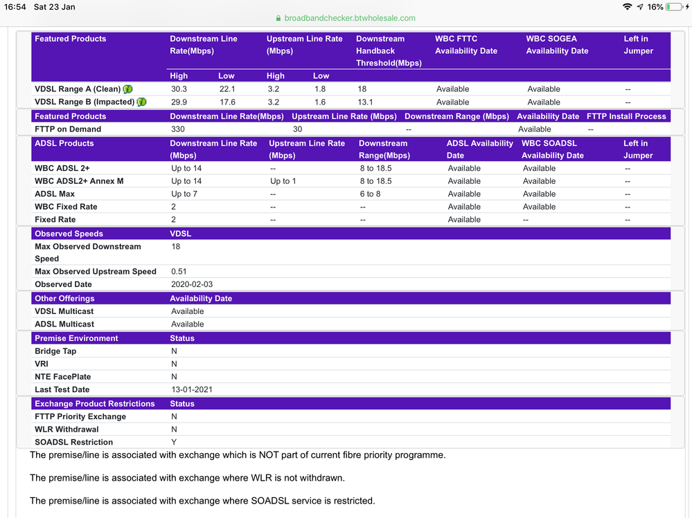

welcome to the BT community forum where customers help customers and only BT employees are the forum mods
in order for the forum members to help please can you post the stats from your router (if hub enter 192.168.1.254 in your browser) and if  HH5 then go to troubleshooting then helpdesk and if HH6/SH2 then advanced settings then technical log information .
Have you tried the quiet line test? - dial 17070 option 2 - should hear nothing - best done with a corded phone. if cordless phone you may hear a 'dull hum' which is normal
enter your phone number and post results  remember to delete number   https://www.broadbandchecker.btwholesale.com/#/ADSL
Someone may then be able to offer help/assistance/suggestions to your problem

Post the results from the checker site to see what you should expect and your router stats to see what you are actually getting......any speed check needs to be done using a wired device

Message 6 of 6
Re: Upload speed
762DC33D-578B-49B3-B724-F5B07749393C.pngHopefully this is the right extra info !
I can’t do a clean line check as although I have to rent a line I don’t have a phone that works
