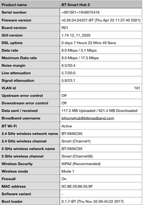

Is this the information from the Hub 2?

Go to solution
Hi @nannajan13 yes that's the info I needed thanks. The SNR is very high at 30.4db it should be around 6db, so it looks like you're in a banded profile due to instability on the line. Are you noticing if the Hub is disconnecting and lights going off/changing colour as the connection time is just over 7 hours?
