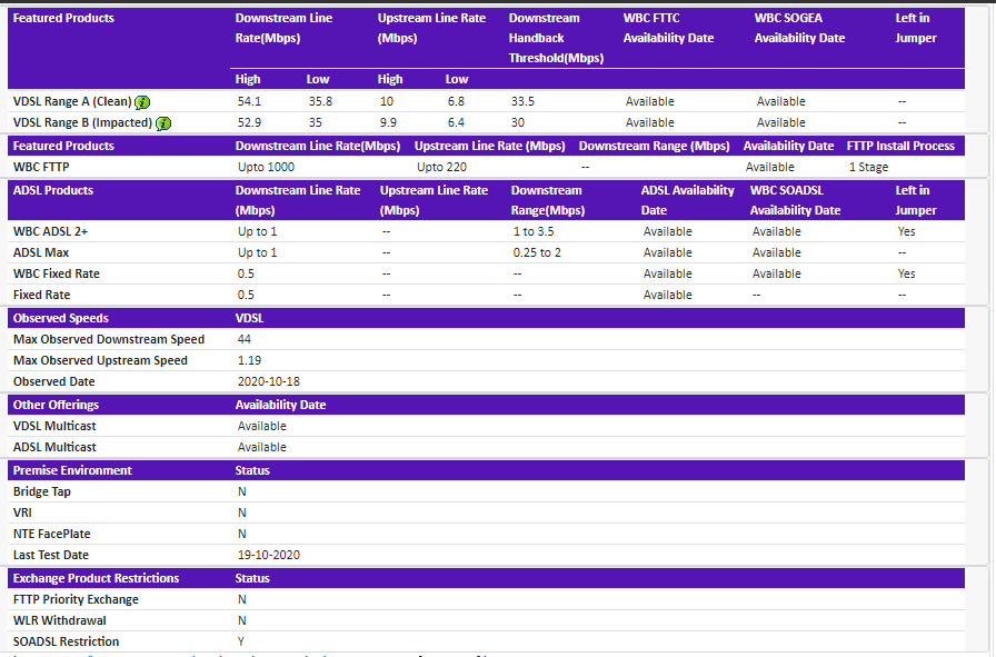

The BT availability checker gives me VDSL clean 57.2-40 download, 11.5-7.4 upload, Max observed speeds 50.75/1.18.

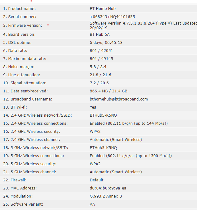

in order for the forum members to help please can you post the stats from your hub enter 192.168.1.254 in your browser and then go to troubleshooting then helpdesk

enter your phone number and post results  remember to delete number   https://www.broadbandchecker.btwholesale.com/#/ADSL

Hi - hub helpdesk:

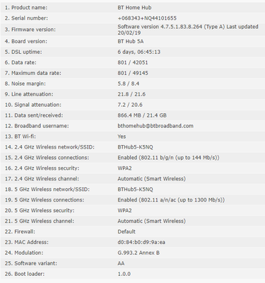

Hi - hub helpdesk:
Home Hub 5 helpdeskHome Hub 5 helpdeskBT ADSLBT ADSL
