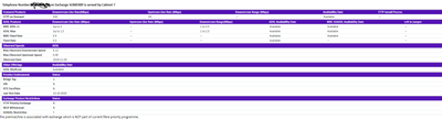

Home Hub 4

sorry these stats give little helpful information  can you try
http://bthomehub.home  admin password is on the card on the back of the hub.
From the top Menu > Troubleshooting
> Helpdesk
> Bandwidth

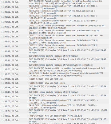

You may be able to gain a little more information from the event log, such as the SNR Margin, shortly after a resync.
Troubleshooting >
Event Log >
Category 'WAN'

@mrunhappy1
You are only on ADSL Max, so you may possibly benefit by regrading to ADSL2+ which normally gives a better upload speed.
