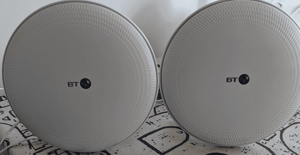

Hi they are the same version. just a different network id as purchased separately.
