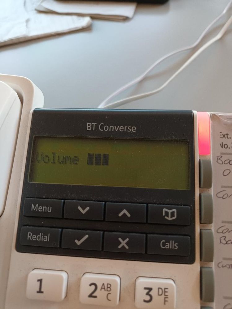

Re: BT Converse 2300 - Ringing Issues
Ringer Volume is set at full as shown in the photo
Then I would say that the internal electronic ringer (powered), is faulty, and turning the power off, reverts to the default line powered ringer.
