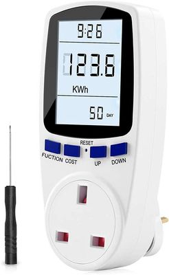

If it is important that you know the exact mains power consumption, why don't you buy a plug-in power meter and measure it?
12,169 Views
Message 6 of 9
Re: ONT power usage
@Anonymous Now that's a good idea.

One thing to note is that Ohm's law can only be relied upon with DC, (Direct Current). It is only correct for AC, (Alternating Current) when the voltage and current are in phase - which only happens with a purely resistive load.
Old style transformer power supplies have an inductive load, whilst I think that Switched Mode Power Supplies present a capacitive load. The consequence of this is that in both cases the voltage and current peaks are out of phase with each other, (ie in one case voltage leads current and in the other it lags it - I can't remember which way around it is?).
The point that I am trying to make is that if you do buy a power meter, the ONT may well show a different reading that the one I calculated above.
If you do buy one, it will be interesting to see your findings - so please post back!
