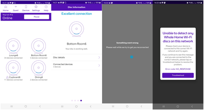

Thought I'd dust off the Wifi6 discs I've had in storage waiting on the new firmware and give them a try. So for no random disconnections/reboots but they have only been installed for a couple of hours. Of course this amazing firmware that has taken so long to develop doesn't disappoint, it doesn't let me Manage Devices in the App so therefore I can't create any groups/Access controls, when I select Devices it just causes an error "Something went wrong". I can view the devices via the webpage but of course you can't create Access Lists/Groups there so not particularly helpful. It also still seems to struggle showing devices connected via a switch which is connected to a remote disc which the V1 Disc's don't have an issue with. I'll leave them plugged in for a few days to see how the stability is but not particularly impressed with the updated firmware so far.

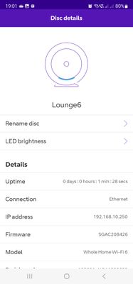

So much for stability, just had the Master Disc reboot randomly. Looks like I should have just dumped these things last year. The v1s are so much more stable, shame BT can't just release a Lite firmware based on that rather this pile of steaming rubbish

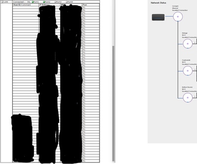

So since the random reboot, there's apparently no devices connected to the master disc and in "total" 16 devices connected to the 4 discs, however my router would disagree as there are 59 devices currently connected via the Wholehome wifi (Port P1). As previously stated these discs are not fit for purpose and this firmware is still absolute garbage.
