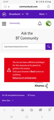

 sorry,  but it won't let me view the instructions on how to switch BT router to 2.4 mghz mode, to be able to use Yoto player  😞
