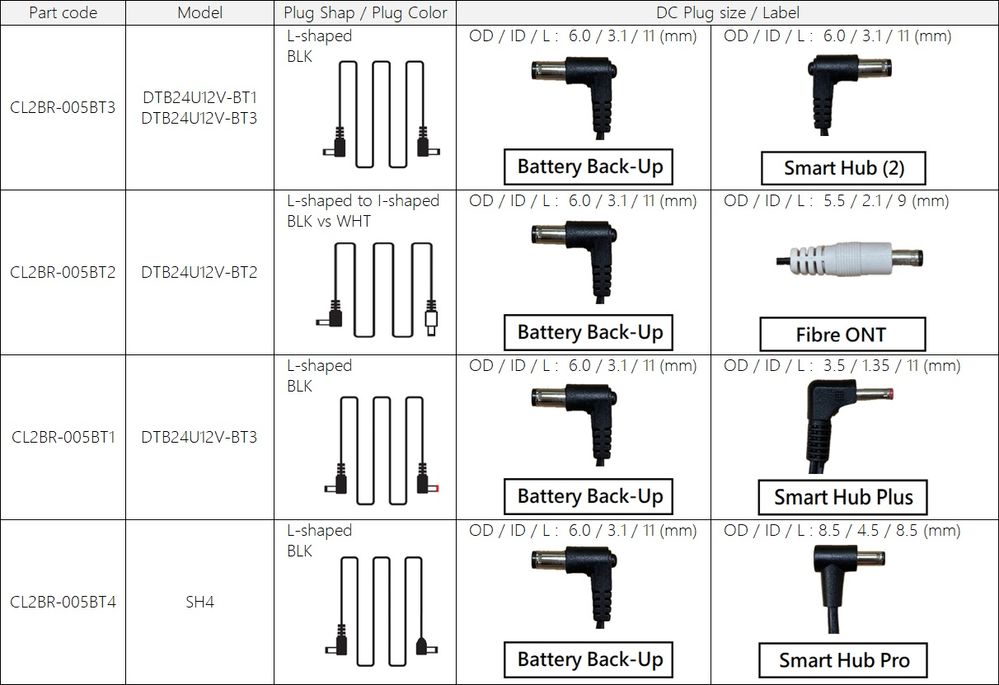

Yes, that's what I suspect the one in the link was for, which is why I couldn't be sure it was the one you needed.
Do you have a model number on the one you already have?  This question has come up a few times and I'd like to get to the bottom of it.  If I have a model number I can query it with CyberPower's own support people.

Yes I just looked & had a picture of the model number, it is 'DTB24U12V'

Just had some feedback from a friend on the EE forum.
"The connector for the back off the CyberPower BBU is the same as the one for the BT Smart Hub 2, Barrel connector 5.5/3.0mm and for anyone who needs the output of the CyberPower is 12V Centre +ve on the cable."

As I said before, 3.0mm is an unusual size.  You can buy the plugs and make up your own lead, if you know how.  Alternatively, buying something like a 2.1mm plug to plug lead and the a couple of 2.1 to 3.0 adapters might be easier.

I've had a reply from CyberPower support.   Apparently, it depends on the model:
