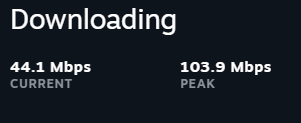

So my current fibre speeds are 1gbps on both download and upload (supposedly). However, when installing games on my PC, I am currently getting an average of around 50mbps (not to be confused with 50MB/s). I have tried optimising this in any way I possibly can, but it simply will not go higher than this average. It might be worth mentioning that when I first started a download, the speed went up to over 100mbps, which it has not done for probably about 2 years, but then went back down quickly after.
An engineer came to the house today and told us that everything was fine and that the speeds that we are supposed to get should be reflecting with downloads, however this is obviously not the case. I did a speed test when I got home on the Speedtest app, and it was showing a Download speed of about 250mbps (again, not 250MB/s) so I thought it may have improved, but it has not.

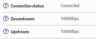

I will attach images to show speeds that we should get, and speeds that we actually are getting.If someone could help out, I really would appreciate it.

Hi I appreciate your response. The engineer who came to the property didn't change anything, he just ran a couple of tests to see what the speeds were and then left. It has been this slow for years

The upstream and downstream figures in your screenshot are meaningless, it is just the link from the ONT to the Hub and will always be 1000Mbps.

Hi, im using an M.2 SSD, so perfectly capable of high speeds

This still doesn't explain why your speeds are so slow though as it should be much faster than 50Mbps. I'm getting 120Mbps in steam downloads over Wifi to my laptop and I have a lower package.
