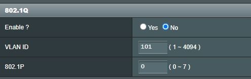

I am using the ASUS in (Under WAN settings)
Transfer Mode: Ethernet Wan
Service Unit: Service 1 (default route)
WAN Connection Type: PPPoE
IP Version: IPv4
Enable UPnP: Yes
802.1Q Enable: No
VLAN ID: 101
802.1P: 0
MTU:1492
PPP Authentication: Auto
TCP MSS Option:0
Internet Detection: PPP Echo
PPP Echo Interval: 6
PPP Echo Max Failures: 10

You do not need VLan ID enabled, the ONT takes care of that.

This is the section where the VLAN ID is. Do you suggest I empty this field. Enable Above is already set to NO.
