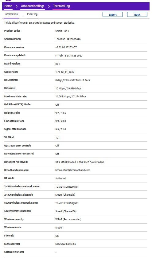

no that's a filter used on the hub logs  you are in the advanced/technical logs and looking for advanced /technical information
you certainly have a connection problem with that number of connection drops.  Have you tried connecting to the test socket with a filter to see if that stabilises your conenction

Is this it?Is this it?

yes that's the stats.
is it possible to try test socket which is behind master socket faceplate?
if that does not stabilise your connection then you need to phone CS 150 and get engineer visit as your connection will not improve until you get a stable connection
