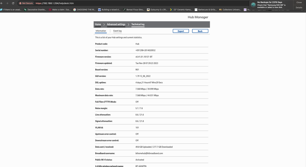

that is from the technical log but you need to go one step further and select information which will give a clearer picture of your connection stats - speed, noise margin, connection time etc.  as previously said there is no SLA on download speed just speed to your router.
can you post information stats please

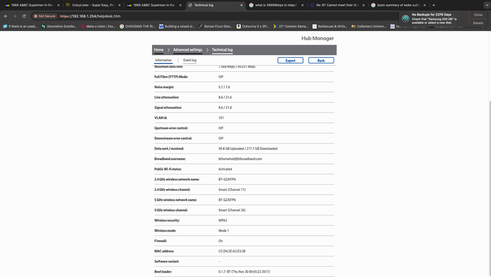

Screenshot 2024-02-23 at 16.05.45.pngScreenshot 2024-02-23 at 16.05.58.pnghope this is correct?

It looks as though your line is either banded by DLM due to instability or has been mis-provisioned as a 40/10 line.
Either way, any increase in speed will be marginal as your maximum rate possible is only 44M

Your connection is only 4 days is that due to manual reset or is your hub dropping connection ?  If so is it often?
You max attainable speed on your line is 44mb and you are currently connected at 40mb. I think this could be restricted as noise margin at 7.6db is higher than normal 6db normally due to DLM taking action on an unstable connection
