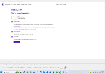

@licquorice To be fair, its not often that I witness the red LOS light, but a flashing green PON light is much more frequent. The signal dropped again this morning but came straight back . As regards the red herring in terms of the stale PPP session, I have been receiving these error reports on an almost daily basis since last October. This report was received about 15 mins ago.
